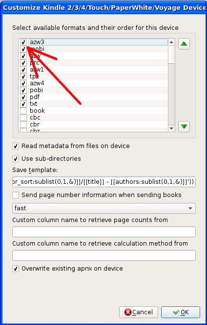

Maybe Kovid disagrees with Apple's policy of dropping support for anything more than a year old.
ID:	144586   Click image for larger version

I didn't send you a screenshot -- I sent you two.
The first screenshot (how to configure your currently-connected ereader) shows you how to find the second screenshot (configuring your ereader to accept specific formats and which ones take priority).
It does assume your ereader is plugged in and recognized by calibre -- because if calibre doesn't see your ereader, how can you send either AZW3 or MOBI to it?

You sent a screen shot - I guess to help. Thanks! First question: how to get there in the first place? I don't recognize it. Bottom line: I just want Calibre (or any other ebook converter software, for the matter - I love a little, healthy competition!) in 2016 to default to AZW3. What's the easiest way to do that, step by step?
On the toolbar, click on Preferences, then Behavior, and you should see an option for "Preferred output format" Choose AZW3, then click Apply.
This one did the trick.
