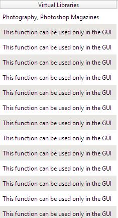

Ok I tried the instructions given in the above link and , like Thinkblot, I had the same error "maximum recursion depth exceeded..."
Then like him I also tried creating the column , but this time as"column built from other columns" (without the "behaves like tags" part)
Now I get this error: "This function can be used only in the GUI".
Interestingly, in both times, the first magazine show up correctly and the column displays teh name of the virtual library that it's in. All the following magazines give the same error.
Question : I used the lookup name: virtlibs.
Is this correct? can I try something else?
Alaa is offline   Reply With Quote

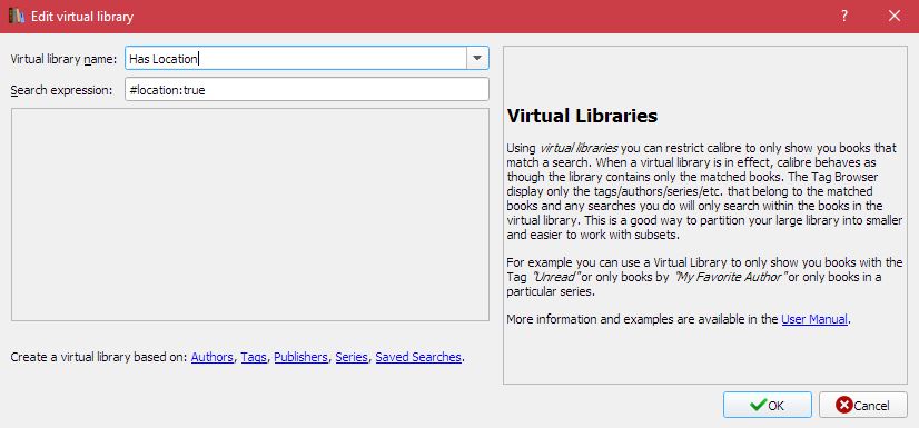

@Alaa - No problems, I'll use screen shots so we get the ducks lined up right on the pond.

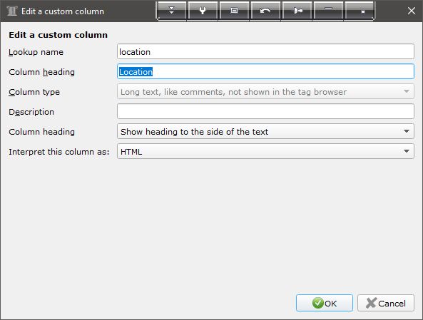

This is my Location column definition
Name:	1 location.jpg

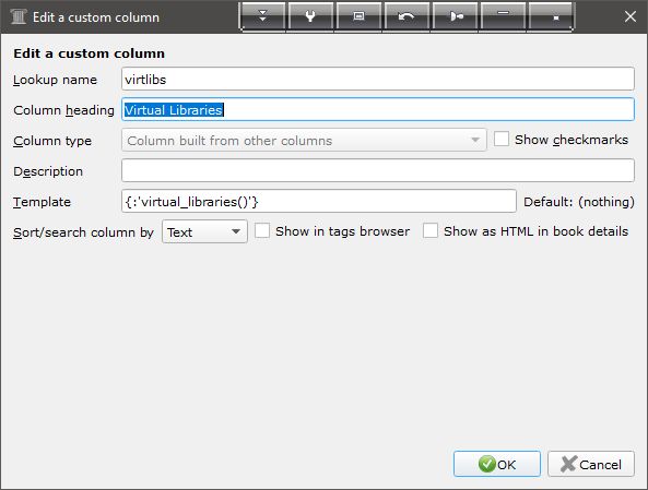

This is my Virtual Libraries column definition
Name:	2 virtlibs.jpg

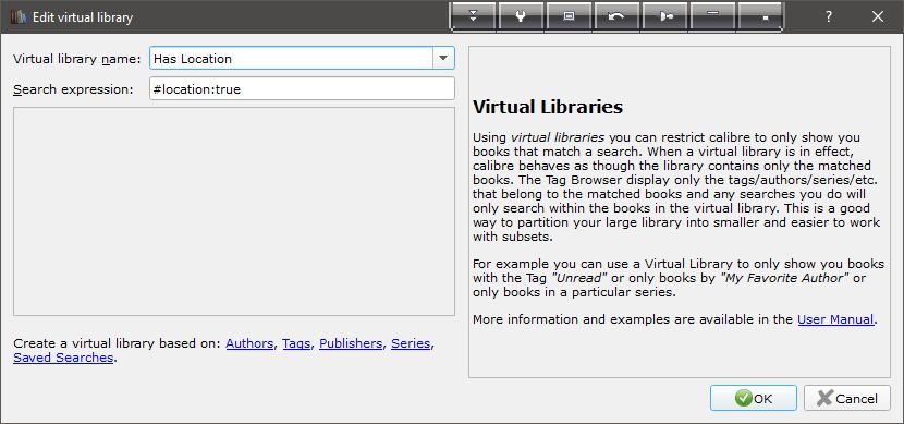

This is my Has Location virtual library definition
Name:	3 haslocation.jpg

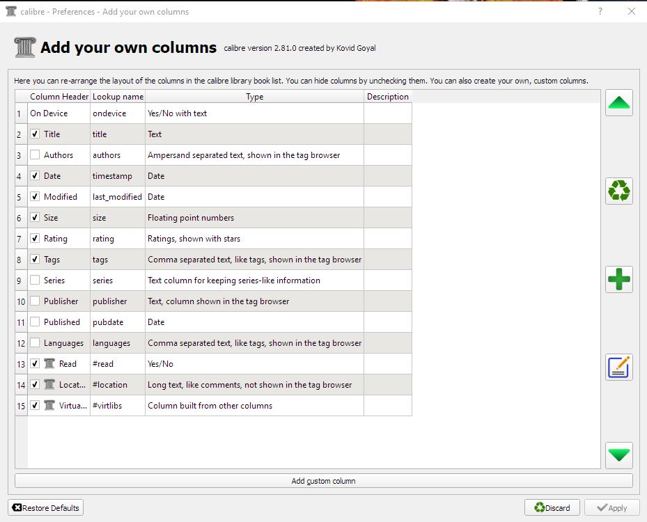

This is my list of columns that get shown in the book list
Name:	4 booklistcolumns.jpg

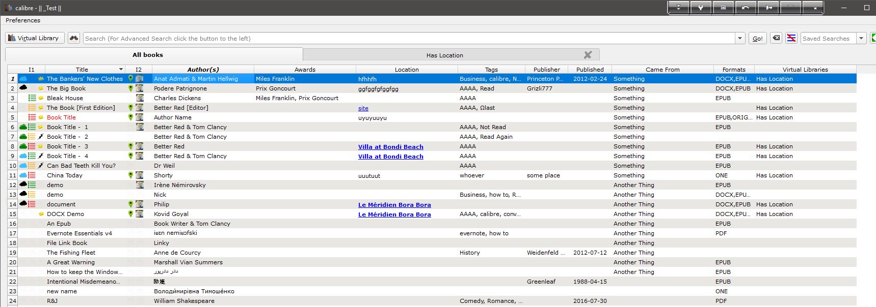

And this is the result - after a library switch or stop start to get rid of the error messages.
Name:	5 booklist result.jpg
Those spurious error messages should be reported as a bug at Bugs : calibre. Would be better if you did that, because you have it on a real library, whereas mine is on my kitchen sink test library. Include a link to this threat in the post.

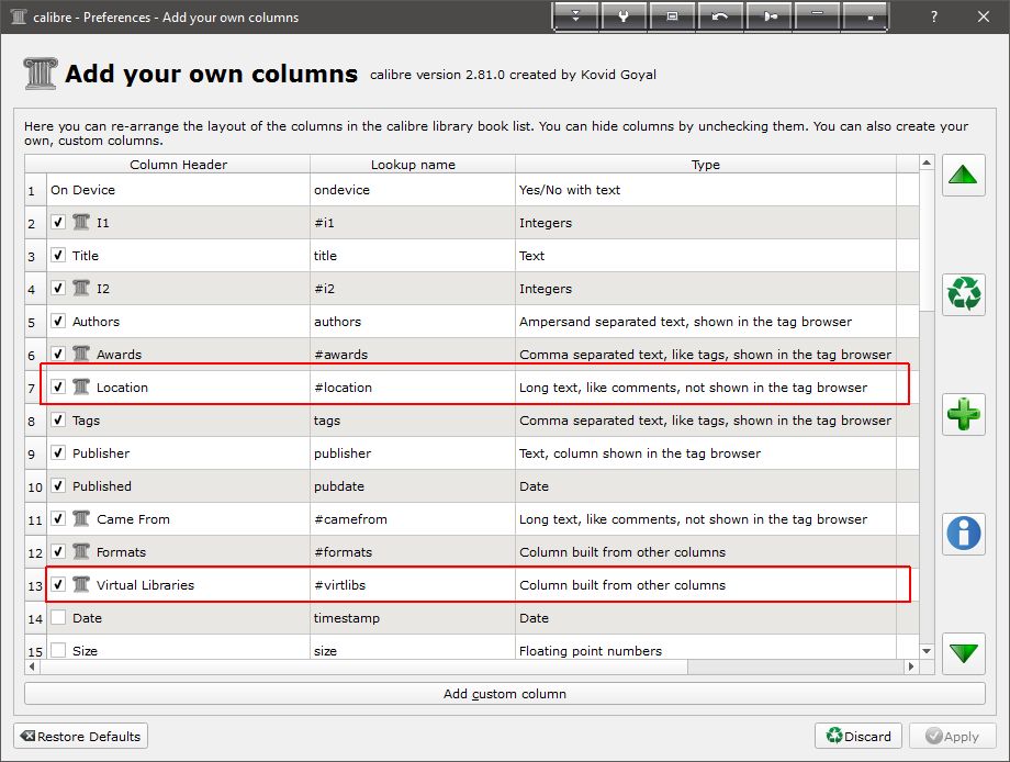

Hi thanks for your amazing help and patience with the step by step instructions and screenshots.
I did exactly as you describe but sadly I 'm still getting teh same result - see image 1.
ID:	155601   Click image for larger version
ID:	155602   Click image for larger version

@Alaa - does it fix itself if you do a restart (Ctrl+R)?
Clearly, there is something not quite right here, but chaley, the template and virtual library aficionado, is now aware of it. So hopefully between your posts and mine he will have enough information to figure out what's happening and fix it

I cannot reproduce this problem. I created a new empty library, copied some books to it, added the two columns, created virtual libraries based on the contents of #location, and it worked.
I might be able to figure out what is happening if you send me a (zipped) copy of your metadata.db file. If you are willing then send it to calibre_bugs [AT] charles [DOT] haleys [DOT] org (make the obvious substitutions). Don't send any books. The metadata.db file is in the top-level calibre library folder.
