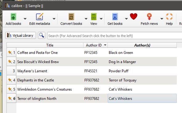

What I want is a list of books that have Author Ids that have multiple associated Author(s). So, in the attached screen shot the books from FF12345 and FF937682 would be displayed, but the book from FF45321 would not be displayed.

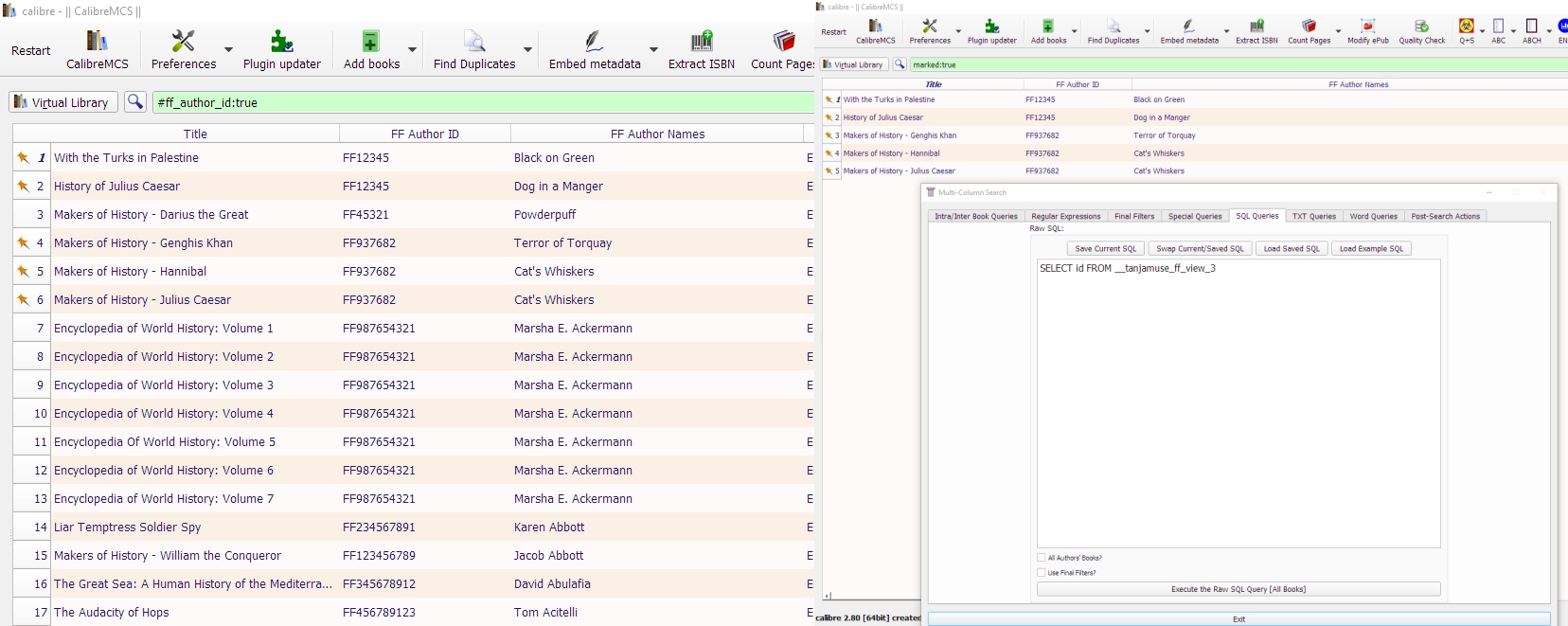

See the attached image showing the "before" and "after" Calibre books selected.
To make this work for you, the following SQL shown in Steps 1-3 must be executed sequentially in a SQLite tool, such as SQLite Manager for Firefox or DBBrowser for SQLite.

Using the MultiColumnSearch plug-in, execute this query in the Raw SQL Query Tab:
SELECT id FROM __tanjamuse_ff_view_3

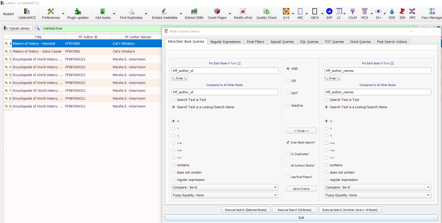

MCS Inter-Book queries require the "=" operator on both sides, so it cannot derive the correct answer to this problem. See the attached image showing the results, and then compare that to the image in my prior post showing the correct results for Tanjamuse's scenario using an MCS Raw SQL query.
