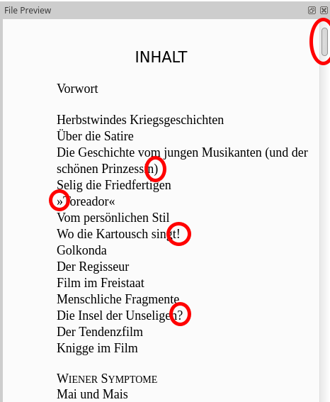

Inhalt Start of Contents of one book of six. Alltogether more then thousand headings. That needs a sophisticated system. In accordance with the character on an ID such one should look like e.g. u7yl38 - like a randomly generated sequence of characters - not like Mai_und_Mais etc.
