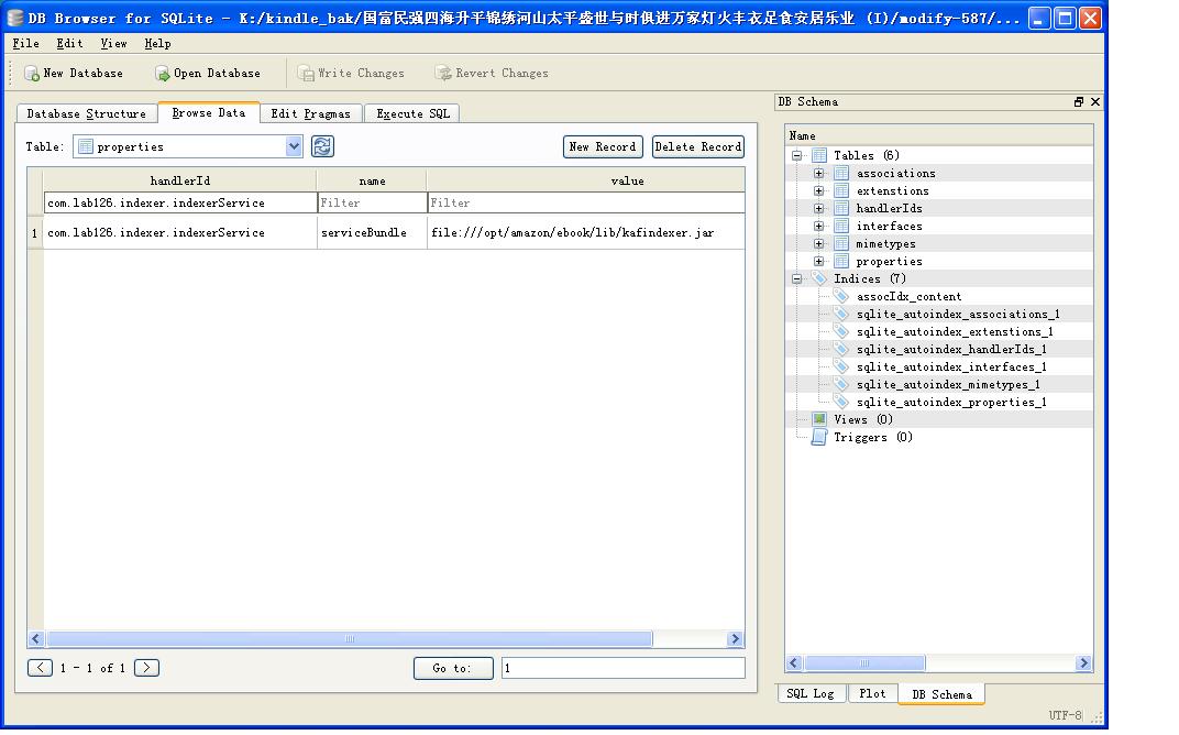

This is my * guess *
Open the /var/local/appreg.db in DB Browser for SQLite and found the associations of the indexer. (Post in the attachment.)
Then modify the database file or the prereg.db in /opt/var/local.sqsh and remove the associations or delete the kafindexer.jar file from the root file system.
I think the first method has more possibility to success.
Because my Kindle is waiting for rescue, I will verify for it after my Kindle is debricked.
EDIT: These ways makes Kindle show repair screen, so do not use these ways.
We should think out another methods.
