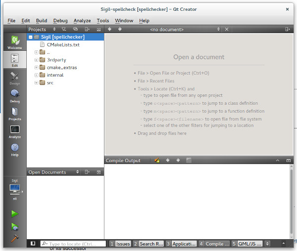

First: the development environment. I'm using QtQreator (comes with Qt and has a good online help) in Ubuntu 14.04/64.
So let us start QtCreator.
to be continued...?

QtQreator and cmake project short howto
I skipped the part about getting sources and dependencies - you can find all necessary information here .
QtQreator is running .
[File]->[Open File or Project] menu shows "Open File" box, let's navigate to source folder (Sigil) and chose the "CMakeList.txt" file there. QtC shows then "CMake Wizard" and wants to know where we shell build Sigil, I just Next'ed its proposal. Now it wants to "Run CMake" and offers us an opportunity to give it some arguments. I use something like this:
-G "Unix Makefiles" -DCMAKE_INSTALL_PREFIX=/path/to/install -DCMAKE_BUILD_TYPE=Debug -DCMAKE_PREFIX_PATH=/path/to/qt/cmake/lib -DPYTHON_LIBRARY=/path/to/python3/library
so in real life it looks like that:
-G "Unix Makefiles" -DCMAKE_INSTALL_PREFIX=/home/varlog -DCMAKE_BUILD_TYPE=Debug -DCMAKE_PREFIX_PATH=/opt/Qt5.5.1/5.5/gcc_64/lib/cmake -DPYTHON_LIBRARY=/usr/lib/python3.4/config-3.4m-x86_64-linux-gnu/libpython3.4m.so
Debug because I expect many many errors . Otherwise it would be Release.
Now QtC runs cmake: no errors so just click on "Finish". QtC parses/indexes.
To check if the project really builds I click on green arrow down left - should build and run Sigil.

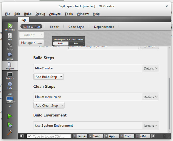

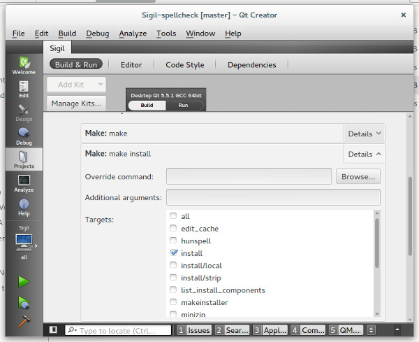

The moment of enlightenment came in the morning, as I rode my bike to catch the 7:26 train. So silly...
My bad habits from old Sigil work flow! This new python Sigil needs to be actually installed for QtC to run it!
So as soon as I could - some 12 hours later - I opened QtC and clicked [Project] item (fifth down on the left - see pictures), there under "Build Steps" [Add Build Step]->[Make] just checked box by "install" item. Just for a good measure "-j 4" by the [Details]-"Additional arguments" for the first build step (make) to use my four cores.
Now click on the green arrow and...
and...
Sigil runs of course .
Now would be perhaps good time to do some real work?
to be continued...?

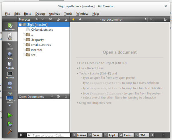

QtCreator and Git
A week is gone and all I managed was to compile Sigil - in fully equipped and configured system... doesn't look good, does it? Now perhaps dear Sigil users you start to appreciate having Kevin & Dough on the watch...
Well, my problem is prio 2, just nice-to-have, no deadlines, no stress. Proceeding accordingly.
One thing more has to be done before doing some real work: freezing the original state of the source and starting a new branch. So in QtC we go to [Tools]->[Git]->[Local repository]->[Branches...] and then click on [Add]. In "Add branch" dialog box I name the branch "spellchecker", OK it and the following question "Checkout branch?" answer with yes. QtC shows that is now on the branch [spellchecker].
Now what?
to be continued...?

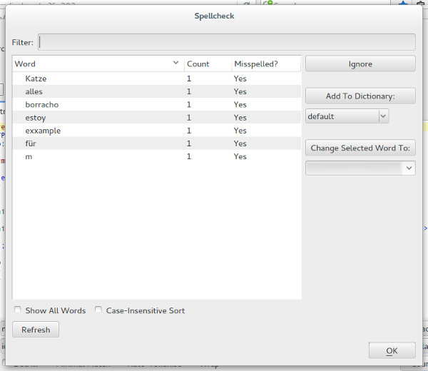

In The Source: LOST IN SPACE
Had a little more time today...

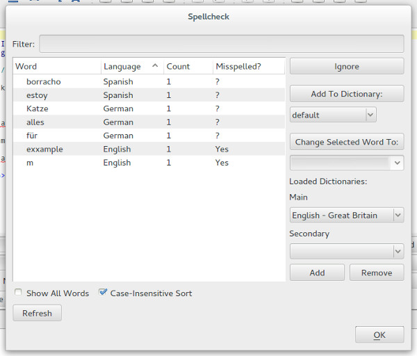

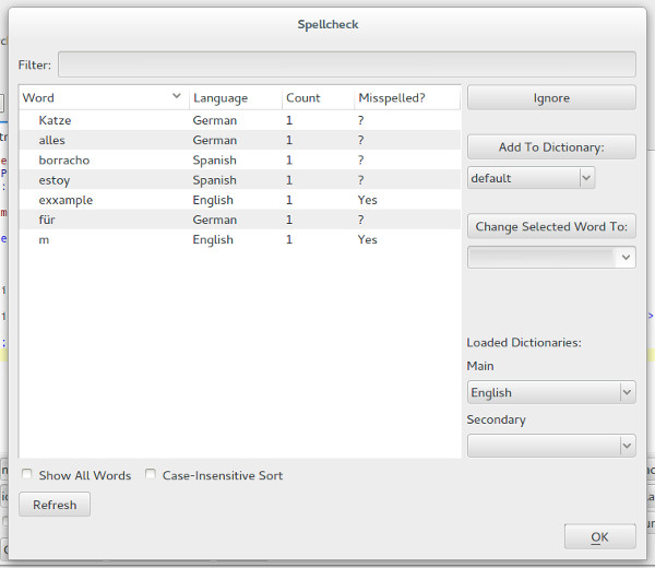

So src->Dialogs->(SpellcheckEditor.cpp, SpellcheckEditor.h).
This class is responsible for spellchecking cockpit you all know so well (see first picture). The graphical side of it is described in separate file:
src->Form_Files->SpellcheckEditor.ui
in human-readable xml format.
I did a lot of jumping around, met some new classes ("Language" in Misc have some handy functions for one) and old scary acquaintances - but I run away from them again...
It seems to work like this: class MainWindow - which, as you rightly suspect, is responsible for the main Sigil window - initializes, well... dumb class SpellcheckEditor. Dumb because it doesn't know at the moment of creation what book it is supposed to work on. It is important: it means that some useful things to be done have to wait...
MainWindow creates or reads in a new book using the SetNewBook(QSharedPointer<Book>) function, which, among others, tells SpellcheckEditor "Hey, have book". To do this it uses function SpellcheckEditor::SetBook(QSharedPointer<Book>), which is public function of... wait now... SpellcheckEditor! MainWindow, by initiation, first creates Book and than SpellcheckEditor: some time travel here?
BF begins (B is for Brain).
Ok, let it be for now...
I did some things to function SpellcheckEditor::CreateModel(...), wrote some help functions, wrote one fake five-liner (to deliver language of the words), meddled with SpellcheckEditor.ui - QtC has a graphical editor for this, but I prefer to do it manually: this way the diff patch is smaller.
The idea was to create preliminary mock-up of the end product, as a focus for farther thoughts and to get used to Sigil and C++ again. See second picture for results, done on the same sample as the first one.
tbc...?

Eh... it's just an awesome title... and I am considering... but perhaps "The Waste Land" would be more appropriate .
I'm working on SpellcheckEditor cockpit, implementing slowly underlying functions, learning, discovering problems and fighting with them. Did you know that different languages tend to have its own alphabetic order? Despite (almost) the same alphabet?
I certainly won't be implementing that! I mean, if it's not implemented already...?
But surly the different dialects of the same language have to be dealt with.
I decided, for the time being, more or less, to follow this architecture:
MainWindows tells SpellcheckEditor "here, have book!"
SpellcheckEditor asks Book "hey Book, what language you?"
SpellcheckEditor asks Spellcheck "say Spellcheck, what dictionaries you having?"
SpellcheckEditor tells Spellcheck "Spelly, get them dictionarys, ok?"
They are just simple program subroutines, so their conversation is not very sophisticated...
I still don't know how SpellcheckEditor gets his first book. Must be missing something obvious...
See picture for latest cockpit.
tbc...?
