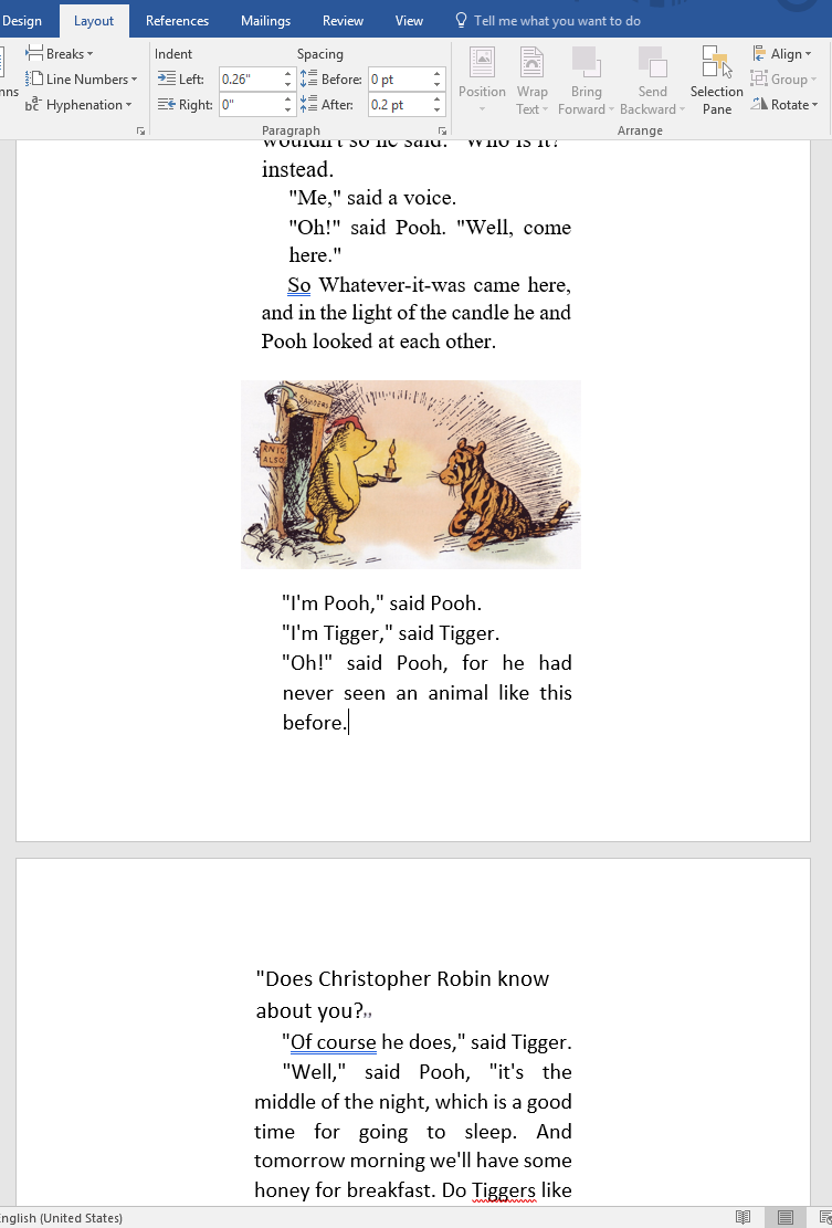

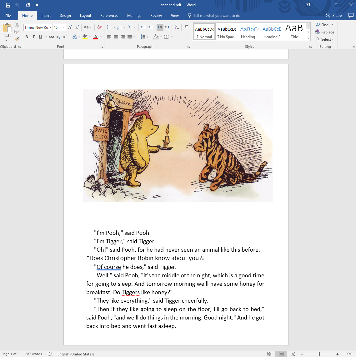

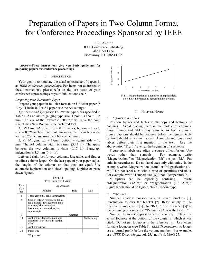

For the purpose of re-formatting (potentially eventually into mobi/e-pub) so they are easier to read with an e-book. I've attached example PDFs and related thumbnails from (a) the PDF, (b) the PDF loaded into MS Word, and (c) a re-formatted version of the PDF in MS Word. For each case, I loaded the PDF directly into MS Word (subscription version of Office 365 Home), then did nothing but a 30-second re-format by changing the margins. No editing.
1. Computer-generated, fairly complex layout--two columns, inset graphics/tables.
2. Scanned from a book.
In both cases, I can quickly get to a very readable solution with minimal editing work.
ID:	153719   Click image for larger version

ID:	153722   Click image for larger version
ID:	153723   Click image for larger version
