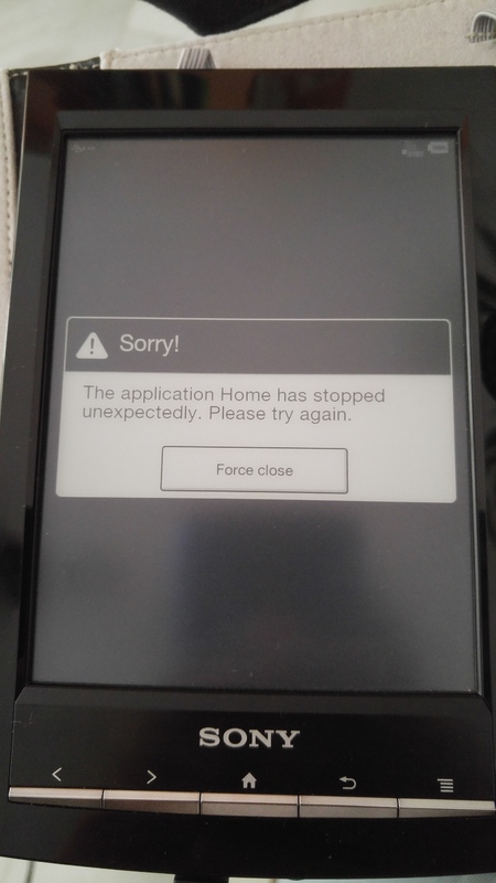

SONY PRS T1 Sorry! The application Home has stopped unexpectedly. Please try again.
Hello. I need help. I know this is and old reader but I hope someone here can still help me fix it.
I fear I brick my reader when trying to root it using Rootset-Mynimo-B3 from here : http://www.mediafire.com/download/g1...imo-B3Home.zip
Well, the reader reboot himself buit when it got back I have the persistent message "Sorry! The application Home has stopped unexpectedly. Please try again." and it gives me the option to force close nut when I press it it just comes back on a on. I can see the wifi icon on standby, the battery and, when I connect the reader to the PC, I also can see the usb status icon with "connect" and "disconnected" when I put the cable on or remove it.
The thing is I can't reach any other option in order to soft or hard reset the reader and I can't connect via data tranfer to the PC to restore or do anything. I tried to hard reset by doing the next page and back buttons pressing but since I can´t load the Home Screen I can't seem to do anything with the button secuence.
I really hope someone can help me. I just reacieved the reader and can't affort any other one. Thank you very much and excuse my poor english.

Here is a photo of the screen https://www.mobileread.com/forums/att...1&d=1479912533
Also, if I press the power button long enough to get the reset screen I can´t press YES because the error screen keeps getting in the way. If I press the power button one time oddly I get the reader sleep mode screen with the book cover of "Around the World in 80 days" (!!!)

What firmware was the T1 running when you tried to root?

The solution to your problem is to start saving for a new Reader. If you had 1.0.04 or earlier, you might have been able to recover. But with 1.0.07, there's no way to recover.

The problem is that the latest SD recovery firmware was created for 1.0.0.4. The t1 was out of favor and many people have moved on since before Sony dropped their bookstore and customers were moved to Kobo.
From what I read, the SD recovery only works if both the SD Recovery and the T1 have the same firmware. So from what I can find, saving for a new Reader is your only option.

Have you tried to download rupors "20121208 - rescue, backup & restore" package and extracted it to a micro-sd-card, put it into your reader and booted into recovery-mode?
Were you able to connect to the console via usb (optional step) and/or was the device presented in your PCs-OS when connected via USB?
If so, the special mini-linux on the sd-card (no android) will allow to rewrite the whole internal memory of your T1, bringing it to a state prior rooting. (Probably messing with some ID-data, but as I assume, an Adobe-Registration will be your least concern).
Now you have to find a good backup.
On page 20 of of above mentioned thread there is a link to another russian forum
There might be the chance to get 1.0.04 (russified) and 1.0.05 images.
OTOH if your device will not boot rupors special "rescue, backup & restore" your are definitely out of luck and will have to follow JSWolfs advice.
