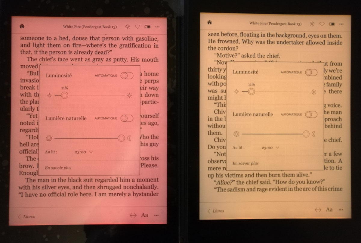

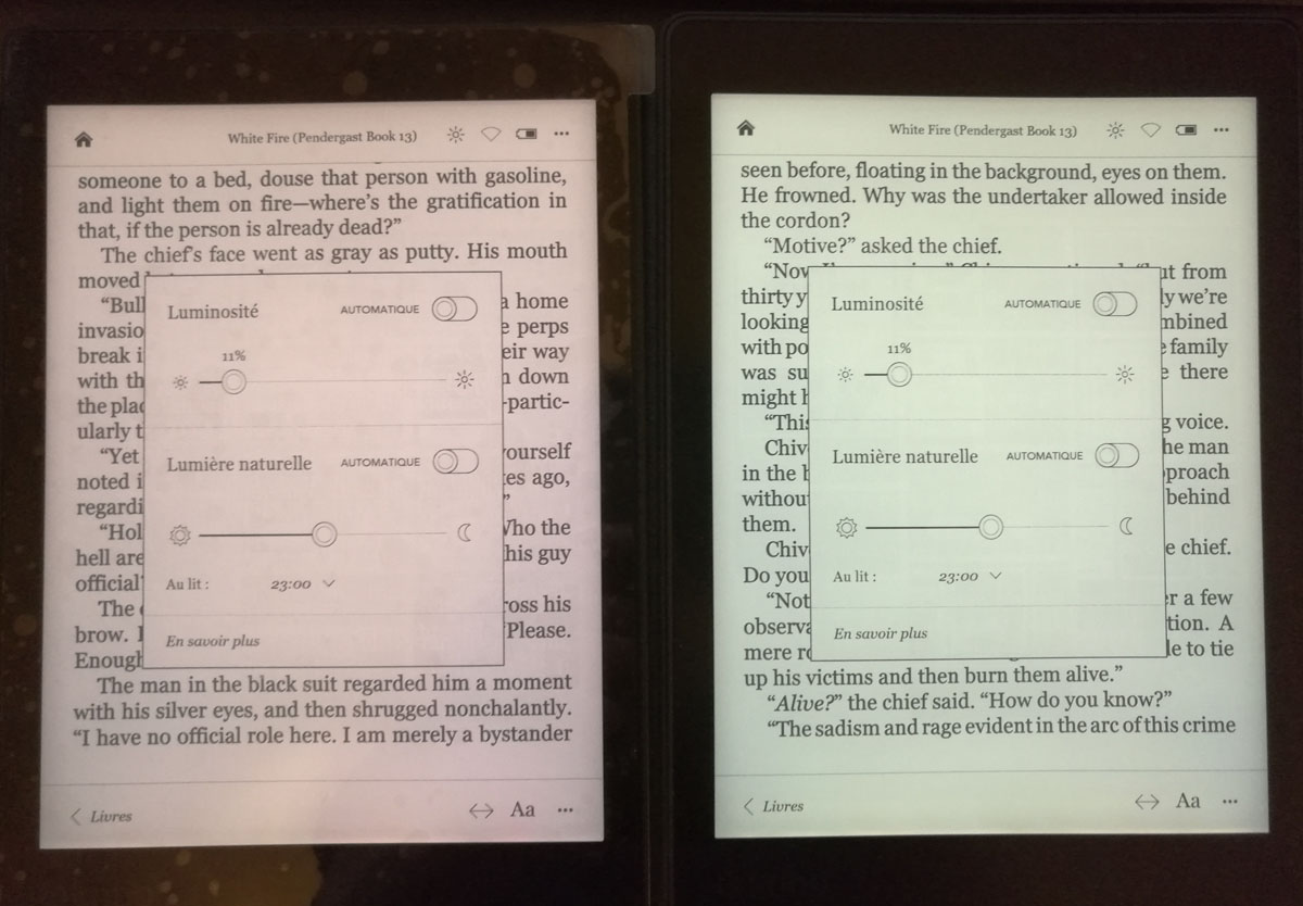

Sorry to burst your bubble, but as far as I am concerned (quote me mentioning all the KA1 out there are lemons), it is indeed factually 100% dud. I didn't speak for others' units, I mentioned the two I had, in a row. Both of which indeed are badly flawed.
Other than that, there are other threads where not only such things re battery have been mentioned (which, again, as best I remember, didn't assert every KA1 out there meets their case), but also sport photo evidence of the ridiculous screen variations. Which makes choosing a KA1 a visual Russian roulette.
You may not like posts tarnishing your fave brand, but then again, had they gotten their act together (KA1 from what I can see generates many more problems than other models, I never had any worries with the Glo HD for example), these posts wouldn't spawn up as much as they are now. Eh.
EDIT: There are the screens variations. No way that can be justified, or excused. Besides, which one am I supposed to determine looks normal and the way it has to?

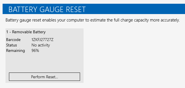

Ummm... power manager on Lenovo laptops has an option to re-calibrate the battery meter. It takes quite a while and involves draining the battery down to 0 and then recharging it to fully charged. And yes, this needs to be done when updating the battery firmware, compensating for the loss of battery capacity over time -- my current laptop shows the original battery capacity to be 93.6Wh while the current capacity is 57.9Wh, replacing the battery and ghod alone knows what other reasons. I've seen this type of utility on several other devices (laptops, tablets, measurement devices) I've owned and/or used over the years.
And I won't even get into the fun we are having with Surface battery life and the seemingly endless series of updates.
