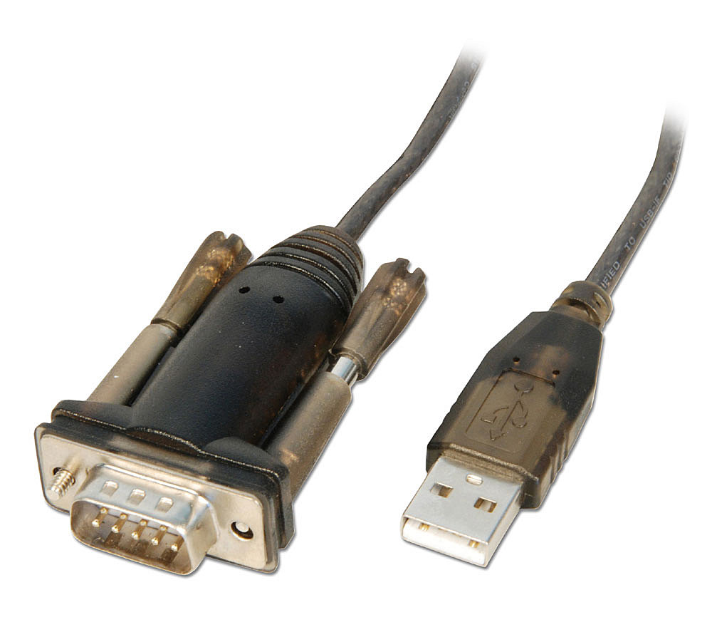

I have a usb to rs232 (F5U103ea ACER),

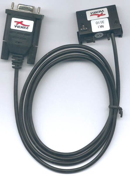

An nokia 3510 rs232 serial cable with 4 wires
The voltage measured is around Vout=0.1v dc

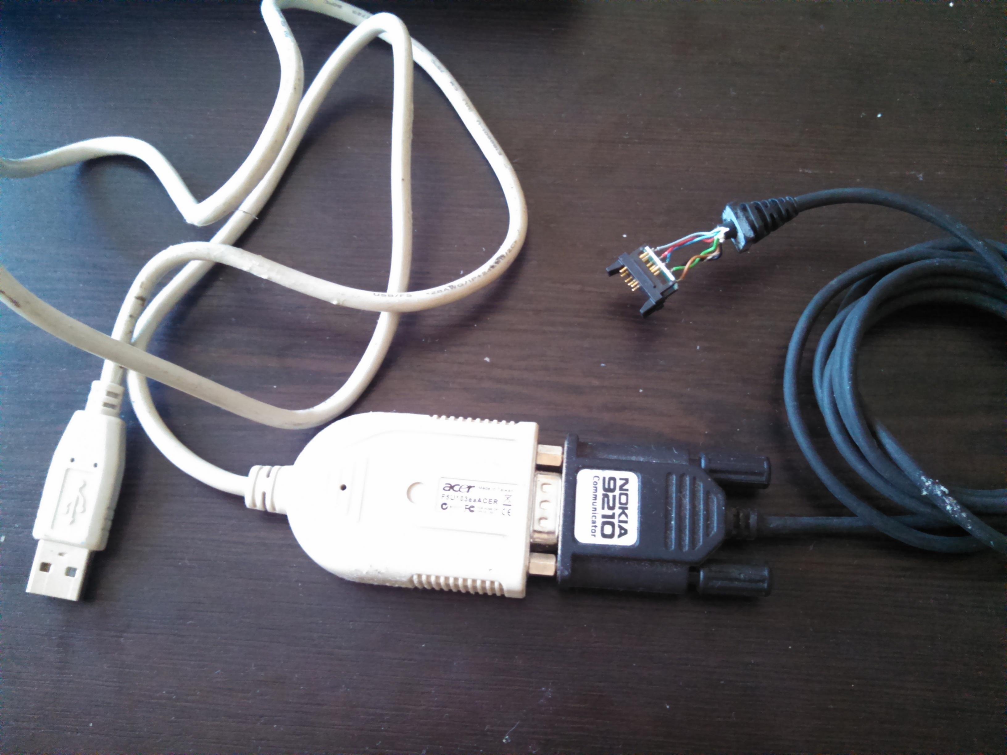

An nokia 9210 rs232 serial cable with 6 wires
not tested yet.
How can i use this to make a fully working serial cable?

I have created the bootable USB with ubuntu in it and my laptop is 3 years old, so no problem. I have managed to make a backup of the original RROOTFS.dmp of my DXG.
I have found the cable for the nokia 9210 to have an output of around +2V DC when connected to a PC(12V input) RS-232 DB-9 port. Is this voltage low enough or i have to put it down through resistors to 0.7-1.2V out?
After the cable is ok, what are the steps i have to follow to reflash it's original rootfs.img?
