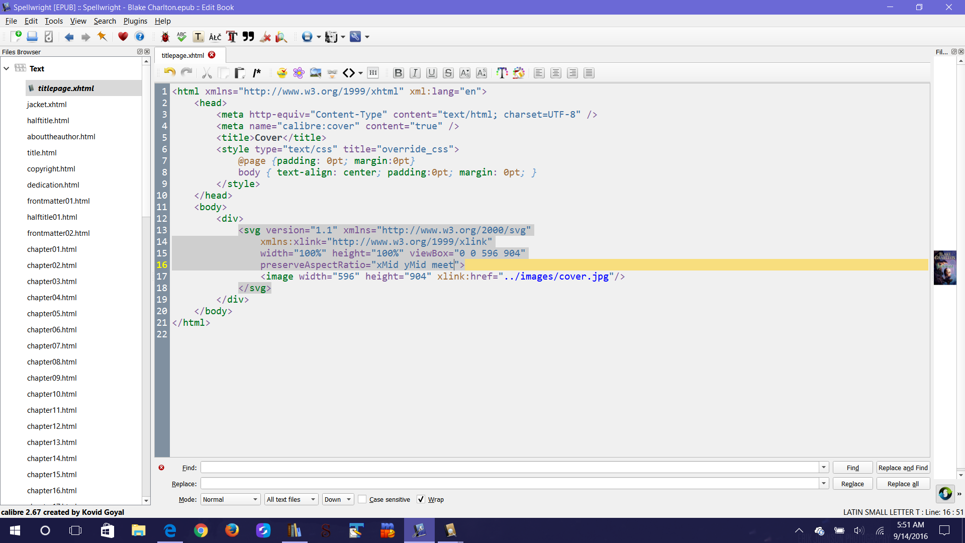

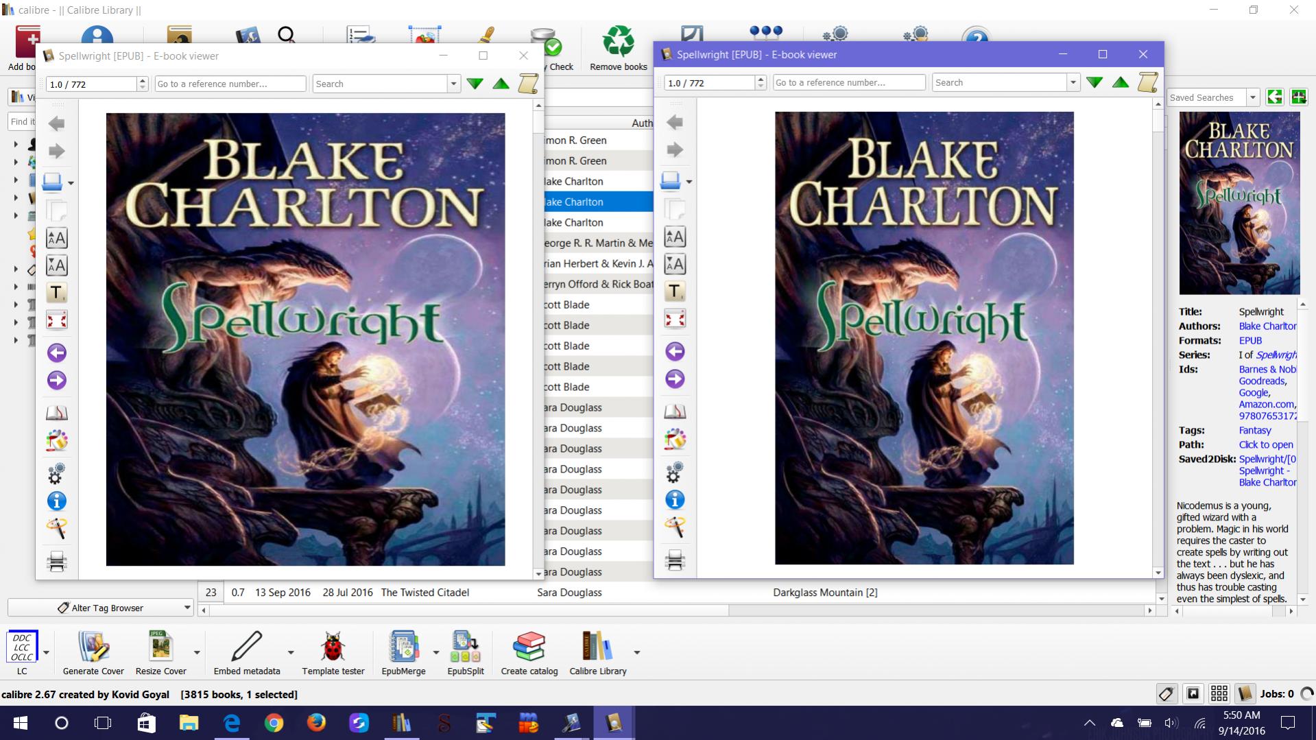

The svg code puts in preserveAspectRatio="none" in Polish ebook. which does not preserve the aspect ratio. The cover fills the screen. I use preserveAspectRatio="xMid yMid meet" which centers and keeps the aspect ratio. So I have to go in and edit each book after I polish it.

Here are screenshots of what I am talking about.
In the first png, on the left is preserveAspectRatio="none" and on the right is preserveAspectRatio="xMid yMid meet".
The second screenshot is the coding
