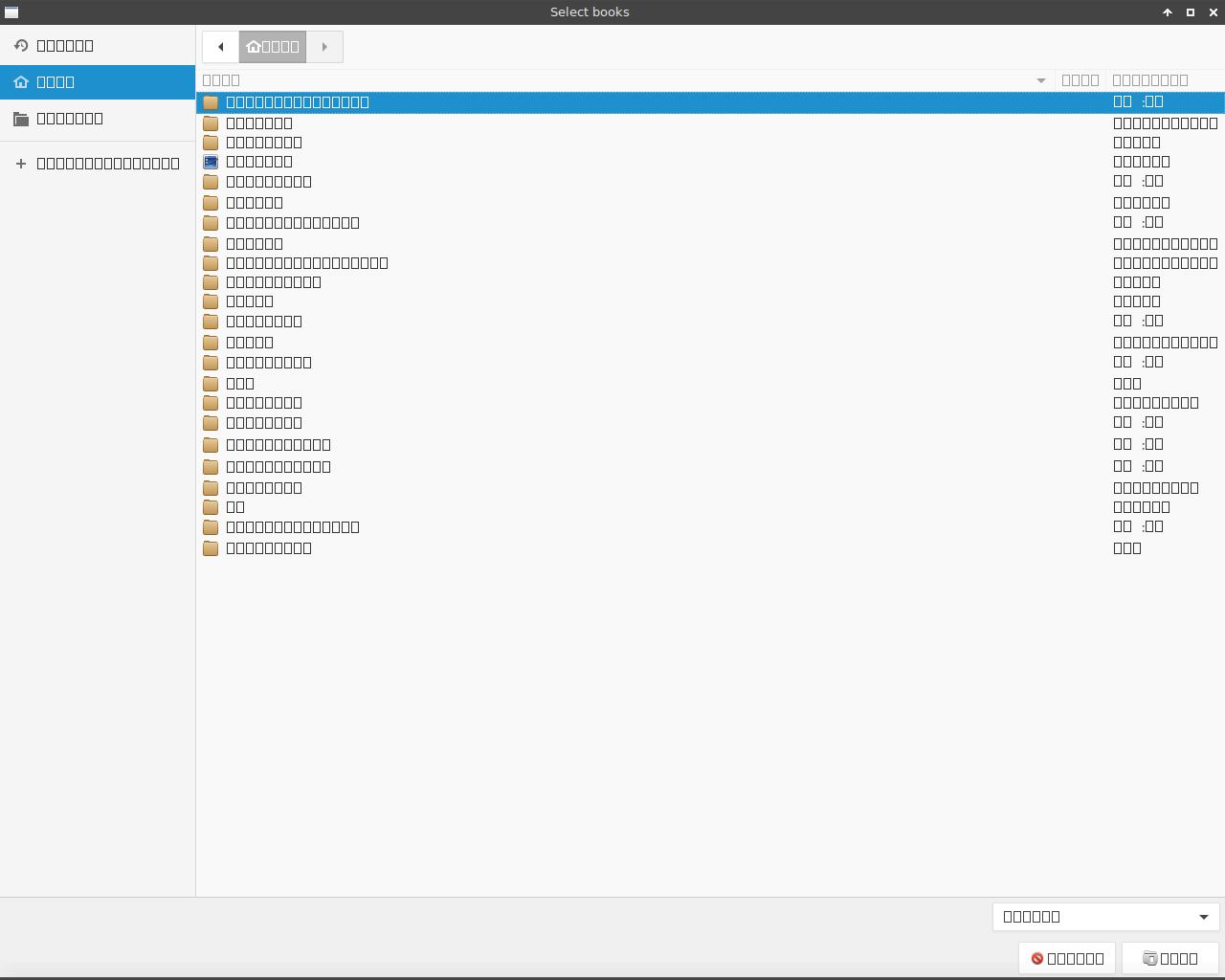

Hello,
I'm running calibre 2.65 on arch linux 64-bit. When I go to "add books", I end up with a dialog screen of white squares/blocks and no text. It seems there's a font issue. I've run fc-cache to clear the font cache. I also tried deleting ~/.cache/calibre to no avail.
I managed to add books a long time ago so I'm not quite sure when this happened. And everything else seems to be working fine. But I'm not at a loss as to how to try to fix what again I assume is a font issue.
This is limited to calibre - all other applications are working fine.
I'd be very grateful for a steer as to how to fix this.
Thanks!
Dangelo

A screenshot would be useful. And note that you can always add books by drag and drop onto the book list.

Thanks for the reply - I've attached a screenshot. Thanks again, D

I have no idea what would cause that, but you can work around it by setting, the environment variable CALIBRE_NO_NATIVE_FILEDIALOGS as described here: http://manual.calibre-ebook.com/cust...ment-variables

Thanks very much - setting the environment variable worked a treat! Cheers, D
