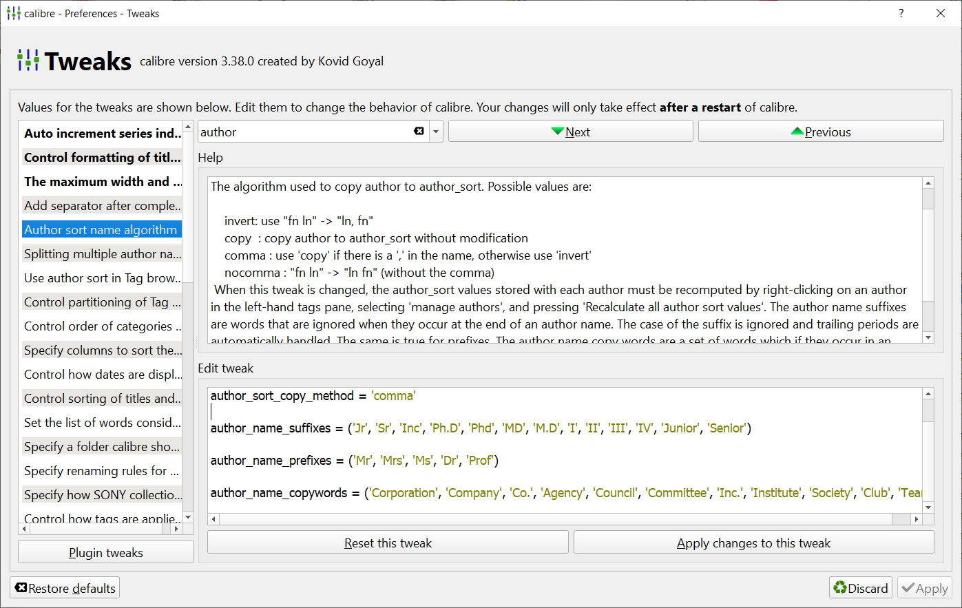

For the author sort being the same as author name, you could try changing the author sort name algorithm to author_sort_copy_method = 'copy' and then recalculating all the author sorts? Look in calibre Preferences/Tweaks.
See attached image for what it looks like.

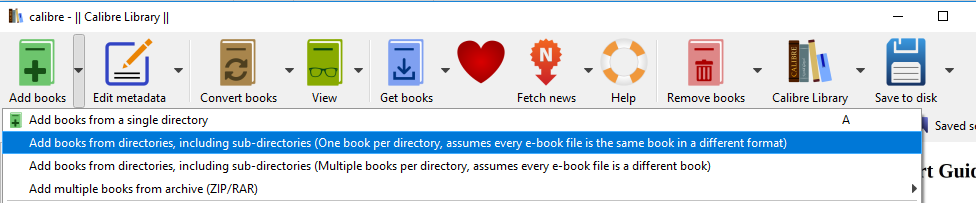

You Added books from your old Library. As been mentioned multiple times, Calibre does not normally UPDATE the embedded metadata in the Library copy for a number of performance reasons. There are tools that WILL do that, but you need to use them on selected books.
_________________
Thank you for the feedback theducks. I have a copy of the original library before i did the laptop refresh. When i reinstalled Calibre i selected the second option for adding books to my library (see image). If i am understanding you correctly, i should have replaced the root folder with the copy of Calibre instead, correct?
___________
Thank you for the response DNSB. I did see that post, but unsure of what i actually need to do inside that text window. Do i copy and paste "author_sort_copy_method = 'copy'" somewhere? Do i amend text?
Step by step instructions would be very helpful please.
Attachment 169355
You would have been better served just copying the entire Library folder to your new HD. That HAD everything (metadata and books) for THAT Library (some of us have more than one)
If you had used the Export part of the Export/Import context menu of the Library Icon, You would have ALL your plugins and other user level (the parts that are not Per Library) settings

Originally Posted by TashPerth View Post
___________
When I tested my suggested tweak, I simply selected the 'comma' text between the single quotes, typed copy, clicked on Apply changes to this tweak, Apply and then Restart calibre. If you make a mistake, it should toss up a syntax error instead of applying the tweak.
I did the test on my Intake library (currently a massive 7 book library) since I did not want to mess up the author sorts in my main library (L. Sprague de Camp is de Camp, L. Sprague NOT Camp, L. Sprague de for instance).
