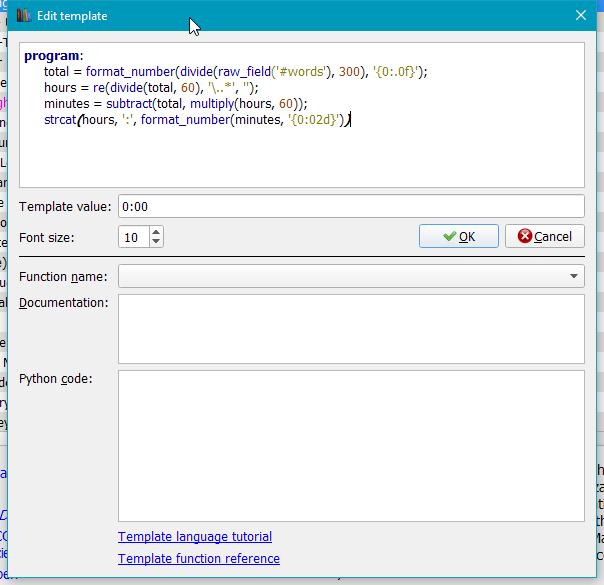

Then you have not entered the template correctly.
The easiest way to edit composite column (column built from other columns) templates is to edit them on the main book list. Click on any cell in the composite column, press F2 (or whatever Edit is on your OS), and paste the template into the resulting editor.

Thanks for your patience. I'd not understood: I'd created separate columns for total, hours, minutes, and final result.
It works very well now. Thank you.
