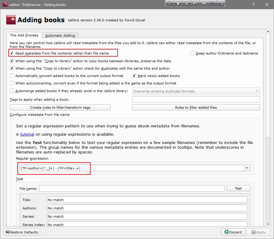

Calibre is getting the Series from inside the book or from the file name, check the highlighted settings :
Attachment 148474
Thank you. I'm going to guess this is it since I almost never import OPF format books. I've changed my default RegExp to see if that resolves it for future imports.
