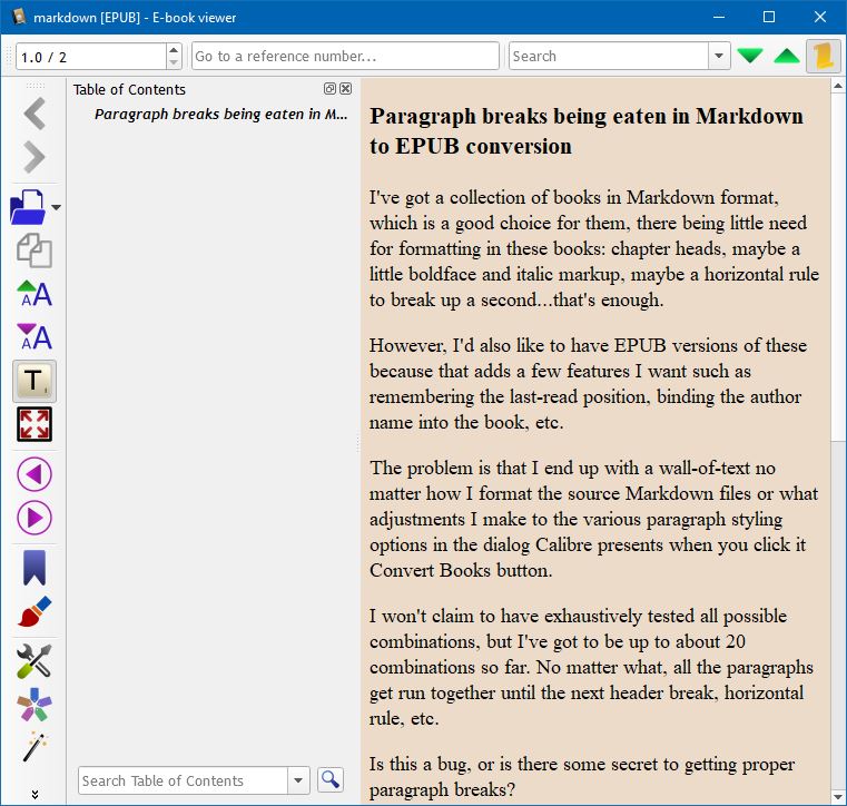

I used 'single' and 'markdown' respectively and it seems to work OK for me.

Originally Posted by wyoung View Post
By resetting my Calibre settings per these instructions and diffing my old settings against that default set, I've managed to narrow the problem down to a single setting: Prefs > Input options > TXT input > Remove indents at the beginning of lines.
Apparently the "Restore defaults" button is page-specific, and I didn't manage to reset this particular page in my less drastic settings resets earlier.
Yes, I see that behaviour as well.
Anyway, with this setting enabled, you get the symptom I've shown above.
This has got to be a bug: there are no "indents at the beginning of lines" to remove! I've placed my example text above on a public web server in case someone feels the need to have a byte-for-byte perfect input source to test this with. But, I really need to stress this: the bug affects pretty much any Markdown input: I've been seeing this for quite a while now, and I've got hundreds of Markdown files in my Calibre library from many sources.
I've got my solution, but I hope someone fixes this problem so it doesn't bite anyone else in the future.
Yes, it is probably a bug. If you report it at https://bugs.launchpad.net/calibre, it should get fixed.
