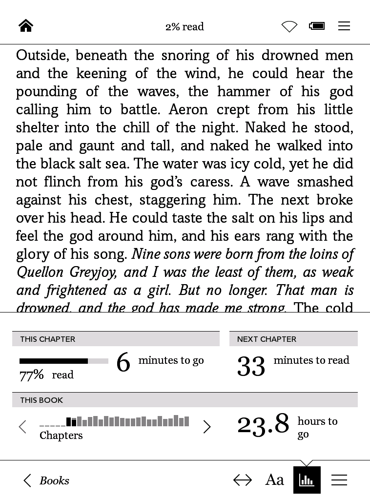

I've attached a screenshot that shows the KePub reading progress popup. Note that the percentage at the top of the screen is for the entire book, while the other one is for the current chapter. In full screen mode you can also see the current page number by bringing up the <-> navigation menu (works for ePub and KePub.)
