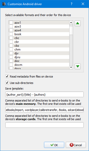

I think you might need to enable CBZ and CBR formats your device type in the Preferences > Plug-ins > Android Device Driver.

This is undoubtedly due to the fact that you don't have CBZ checked as an allowable format in the driver options. This is purely a Calibre configuration issue; it has nothing whatsoever to do with the tablet.
Thank you for your reply. Where can I find these driver options to allow CBZ.

Right click the device icon in calibre and choose configure this device.
