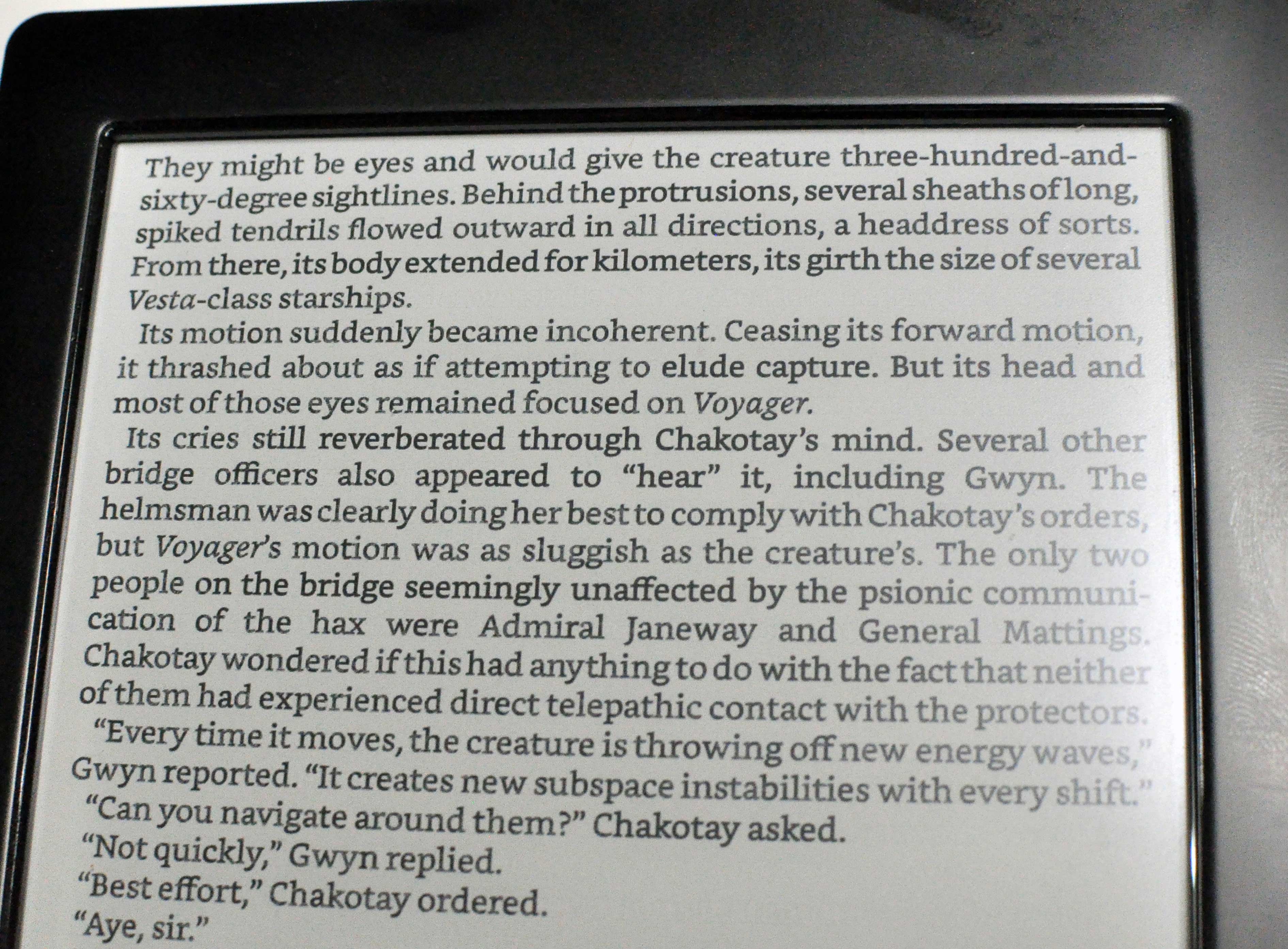

Uneven e-ink rendering
Having had the chance to read on both the Glo HD and the Aura H20. I have noticed that the H20 is somewhat more prone to uneven blackness in the text after multiple page turns. As a result, I've shortened the refresh rate from 12 pages to 6 pages.
The Glo HD on the other hand, seems less prone to uneven rendering of the e-ink text. On the Glo HD, I have the refresh set to refresh every 12 pages.
Just wondering if anyone has noticed uneven blackness in the e-ink on the H20? I'm wondering if this is the norm. My Glo HD does show some unevenness in the e-ink after multiple page turns, but it isn't as pronounced as the H20's unevenness. Increasing the line spacing on the H20 mitigated the effects of the e-ink unevenness somewhat.
Edit: this is using sideloaded epubs BTW.

Erich Zann, I would love to have ghosting similar to what you are showing in your pics. What I am seeing is white dots on black, and it is quite extensive. Now, if this ghosting was similar to what I see on the Glo HD, then I have no problem. On the Glo HD, it’s really quite minor and not an annoyance to the eyes, like it is on the H20.
Geoff, the unevenness can be described as 2) some whole words or areas of the screen appearing lighter than other areas. That’s a perfect description of what I am seeing and I think some of it can be attributed to how the book is formatted. Some of it I think, could be a bad screen. I'm just not sure at this juncture.
I will attach a picture that shows the problem quite clearly. Justification does not work on this particular book as there is no change when I use it. The font used is Bookerly with the weight turned up a little.
The weird thing is that it is inconsistent. At times, the screen looks fine. Others, it’s horribly uneven. The pic shows what I am seeing, but there are times when the problem is more evident than shown in the picture. I took the picture just one page turn after a refresh.
I did a factory reset and the problem was still evident. So I updated to firmware 3.19.5613 again and patched it again. No difference between patched and unpatched.
Pic attached.

KOBO doesn't use eink REGAL wave form technique in its e-reader and regal wave form can reduce the uneven rendering. You can compare kindle voyage or paperwhite3, after 20 or 30 pages, the rendering is still very good.

I used to see something like the OP's picture when waking the H2O from sleep using the sleep cover in some earlier firmware versions. A double tap fixed it and so did a page turn.
