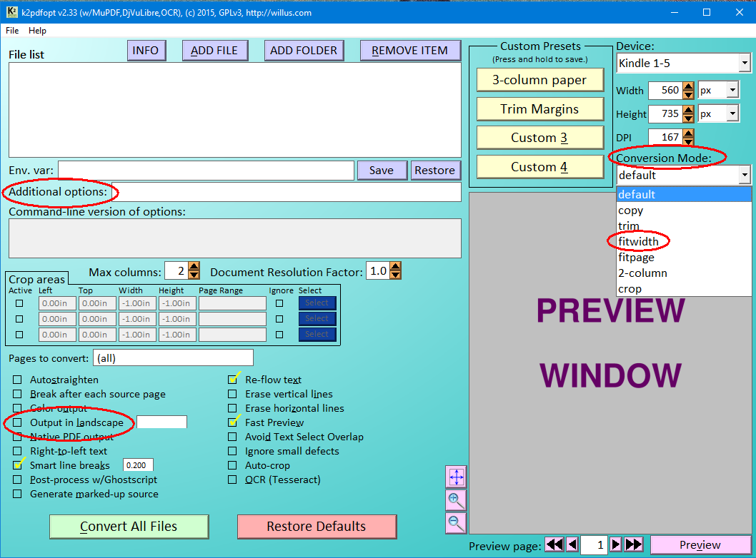

That's an "el" (L) in the -ls-, as in turn off LandScape mode (which is turned on by default when you select "-mode fw"). You can get that by unchecking the "Output in landscape" checkbox. The "-mode fw" can be obtained by pulling down the "Conversion Mode" menu and selecting "fitwidth". There are many options that cannot be selected in the GUI, however, and these can be entered into the "Additional options" box. See attached screen shot. Also, right-clicking on most of the GUI controls will bring up a help dialog box that tells what the control does.
