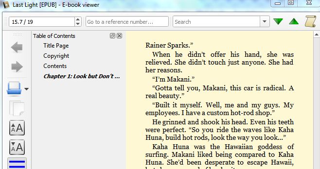

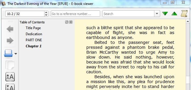

Attached are two SAMPLE books. Also attached are two screenshots of each demonstrating my challenge.
I had to use two different titles for this, but if I have two books where the only difference is the font that appears when the book loads, how can I do a NON-VISUAL test of books to determine if the book font will appear per my specifications rather than maintaining the "times new roman appearance"?
Calibre is set to use the font Tahoma at whatever point I choose. I prefer to have books that follow this. Some, however, do not adhere to those settings. I do not know what to search to automatically determine if the book is like this. Oddly, on another reader, however, the same book will follow the font specification I assign so I don't know that it's some sort of "fixed" font.
I'd really appreciate any help on this. How can I do an auto search to determine the books that will appear on the calibre screen like the "Last Light" book? I suppose the same question can be asked of what to search so I know they will appear like "The Darkest Evening of the Year".

the font Family is the difference.
serif vs sans-serif
I don't know of any search that will look that fine.
The Quality check PI will find books with Embedded fonts.
That does not resolve what font, family or face (there is a report that might help a tiny bit if the file name is detailed)
