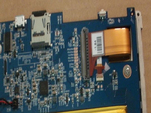

Is the ribbon cable from the display to the back of the PCB all the way in the ZIF connector?
Luck;
Ken
The black bar with the holes lifts to release the ribbon cable, if I recall correctly.
