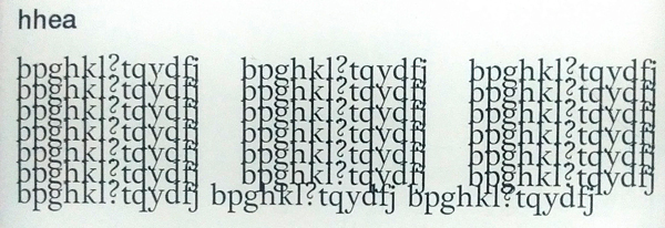

This post is fairly technical and will only be of interest to those designing books for the Kindle that use embedded fonts.
Vertical font metrics is a troublesome area that has never been properly standardised. For an overview of the various strategies font designers can adopt this page gives a summary of the common options.
Unfortunately, while RMSDK-based ePub readers are robust enough to handle these strategies properly, the Kindle is far stricter, and fonts that use the wrong strategy will end up being clipped at the top of the screen and have the wrong leading. The Kindle relies on the hhea values (and only on those values) to set the font's vertical spacing. hhea.LineGap is ignored and the system inserts its own leading value [This was my initial thought, but it's wrong, the hhea.LineGap value is added in to the vertical advance, but I'm still working out a quantitative measure that will distinguish it from the system-applied leading]. The picture below shows an exaggerated example using incorrect hhea values:
Many fonts are aimed at Mac users and layout apps and use the 'Adobe Strategy' described in the page linked above. These will produce undesireable results on the Kindle. The fix is fairly simple, but involves using FLS or a free editing program like FontForge to modify the vertical metrics and ensure that hhea.Ascender and hhea.Descender match the vertical bounds of the typeface's characters. For a full write-up of the best strategy to use, see Karsten Luecke's advice here, which works for the Kindle as well as more generally.

@Charleski: Can you give examples of fonts that have incorrect hhea.Ascender and hhea.Descender values and post before and after pictures?

IIRC, most of those Kindle readers, by default, set the line height to 1.2, and that's the minimum allowed line height, so the minimum distance between lines is 1.2 times the em square. I don't think it cares about the line gap, though IIRC some readers (those using the non-QT version of WebKit, like iOS) do take it into account if the em square plus that value exceed 1.2x the em square. I think.
In the photo above, the em square is probably smaller than the sum of the ascender and descender, resulting in the line height being too small.
I've seen this frequently, mostly with older fonts. I haven't seen it in any fonts created in the past decade or so, because most of the font tools these days provide access to parts of Adobe's font SDK, which IIRC provides (among other things) tools for computing all of those values automatically.

I have modified the metrics in a version of Charis SIL whereby the line height is reduced to something normal on a Kindle.
