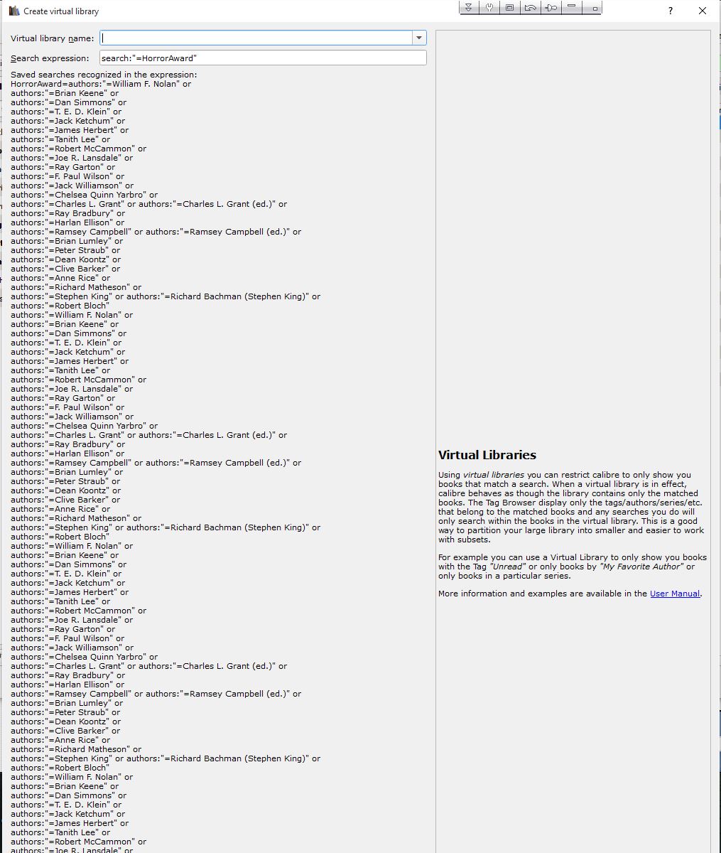

I'm working with a lot of quite complex "virtual library" searches and predefined (saved) searches. Everything is working very well, but there are some small but annoying GUI issues:
  • When editing a virtual library, the "edit" field is only a single line. Editing complex (long) searches would be much easier with a multi-line edit field, like for instance the type used for editing descriptions (minus the html capabilites, of course). Maybe it'd be possible to simply add an additional "Edit" button which opens a separate edit window.
  • As a workaround for the above point I've started using saved searches. Editing is much easier, and it's possible to "layout" or "design" the search with additional line breaks etc., which makes it much easier to read and edit. When I include such a search in a virtual library search, and edit that virtual library search, Calibre will recognize the saved search(es) and display it in the "edit virtual library" window. This stretches the window to the point where the "OK" and "Cancel" buttons are out of the screen area. I think the area where the recognized saved searches are displayed (or the whole window) should have scroll bars.

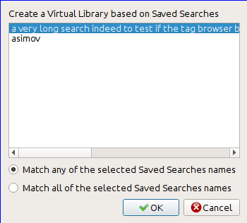

I'm confused, what exactly is too long? The dialog to select the saved search does have the names in a scrollable area. See attached screenshot:

@Kovid - it's the manner in which Saved Searches are displayed in the VL definition - if they're very long one can lose the 'OK' and 'Cancel' buttons viz:

Ah, I see
https://github.com/kovidgoyal/calibr...9c1a2a56e104eb
