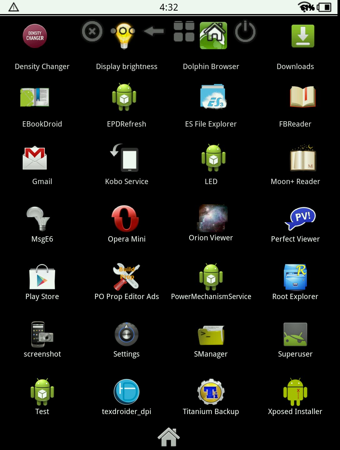

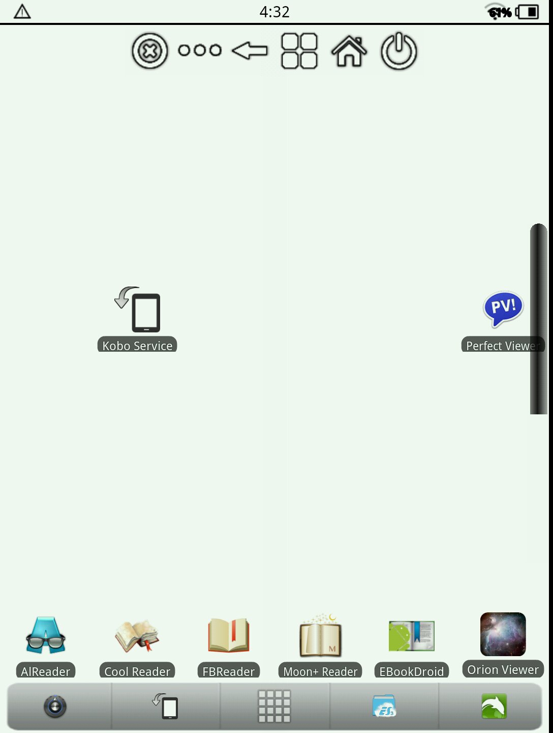

here are the results, don't get confused since the display is rendered in full color on the android, then displayed as grayscale.
the tearing on the apps list is due to taking screen shot during transition.
