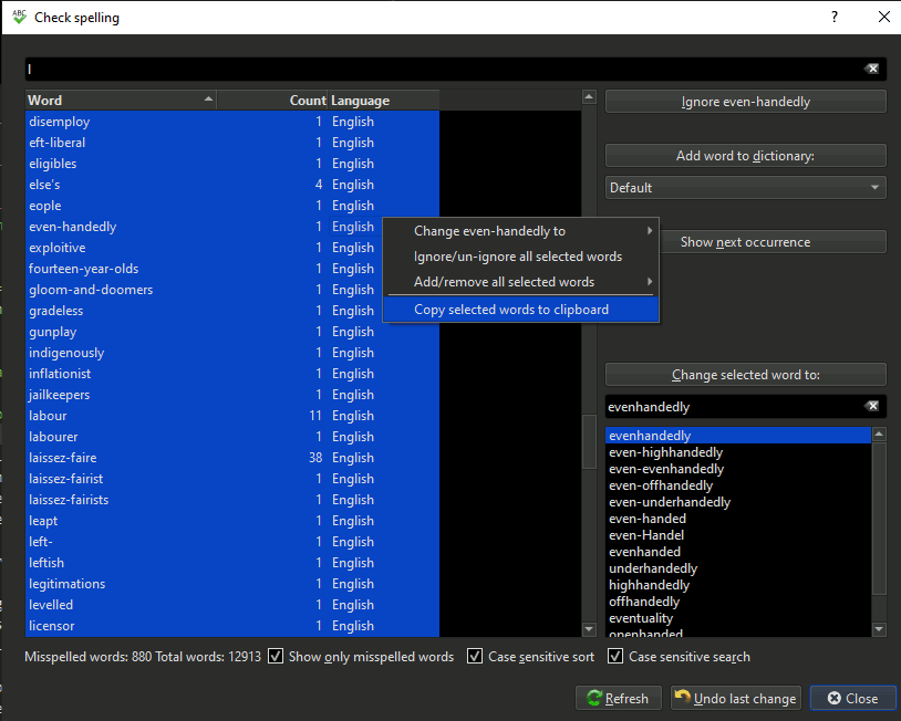

Originally Posted by caseym54 View Post
Is there a way to use regex inside the spellcheck search?
Example: Often misspelled words than erroneously end in "l" are supposed to have exclamation points.
The way that I currently handle this is in multiple passes.
In Tools > Spellcheck > Spellcheck (Alt+Q):
1. I type in lowercase 'l' (or whatever letter I'm looking for).
Then I toggle the "Show All Words" checkbox.
Very likely those "l instead of !" words will appear in the "misspelled words" spellcheck list.
Side Note: In Calibre's Spellcheck List, there's also a "Case sensitive search" checkbox.
Extremely helpful in this case, because you don't want capital 'L' words clogging up your list.
2. After I correct, I toggle the checkbox again (so all "correctly spelled words"), then scroll through and see if I can spot any oddities.
3. Then one more pass at the "misspelled" list.
Note: I do a similar passes with 'l' -> '1' or 'o' -> '0' OCR errors like:
l98l
198o
196os
h0wever
That's one of the reasons why I requested Spellcheck Lists to support numbers back in 2017.
Calibre has always supported numbers. In Sigil, you need to enable it in Edit > Preferences > Spellcheck Dictionaries > "Check Numbers" (tiny checkbox in the very upper right corner).
Side Note #2: You can also use a similar trick to catch accidental/inconsistent hyphens.
I wrote about it in 2013!

Anyway, to tackle the "l exclamation point" error, I would probably handle it this way:
Finding Lowercase L Words
In Calibre:
Method A. Tools > Check Spelling.
You can use whatever search criteria you need. ("Show only misspelled words", etc.)
Then you can highlight all the words (Ctrl+A) + Right-Click > "Copy Selected Words to Clipboard":

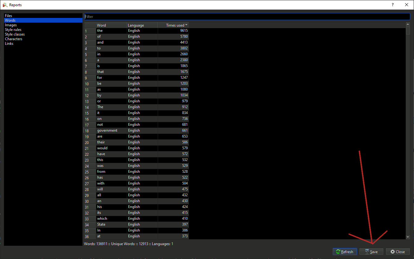

Method B. Tools > Reports > Words.
Press the "Save" button in the bottom right. Then you can save a CSV file:
From there, you can export to another program (like Notepad++ or LibreOffice Calc), where you can run regex or do more analysis.
Side Note: I believe Sigil will be getting more CSV/export functionality in the future.
I ran Method A on a 130k word book:
  • 237 "misspelled words" had a lowercase 'l' inside.
  • Only 25 ended with a lowercase 'l'.
Bobbs-Merrill
Bucknell
Jouvenel
Kozol
Kristol
Mandel
Passell
Samual
Shaull
Stargell
Wittfogel
Wohl
al
calculational
eft-liberal
marshall
nonexponential
nonideological
nonrenewal
ntil
pre-Civil
preindustrial
proindustrial
quotal
warall
Now that list is MUCH easier to look through.
In an instant, you can tell most of these are just people's names.
Then you can see:
  • "eft-liberal" + "ntil" = missing first letter.
    • This ebook had "dropcap" first letter of chapter.
  • "al" = "et al."
    • Common in Non-Fiction/bibliographies. Latin for "and others".
  • The rest are spelled correctly.
    • Except "warall", which was an actual typo (missing an EM DASH between).
This method should catch most of that "l exclamation point" error.
