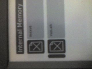

I tested with "mrxvt" and "madplay". After mrxvt was trasfer to main memory in iLiad, I did click run.sh In mrxvt directory. but, I could not see anything.
could you please help me?
