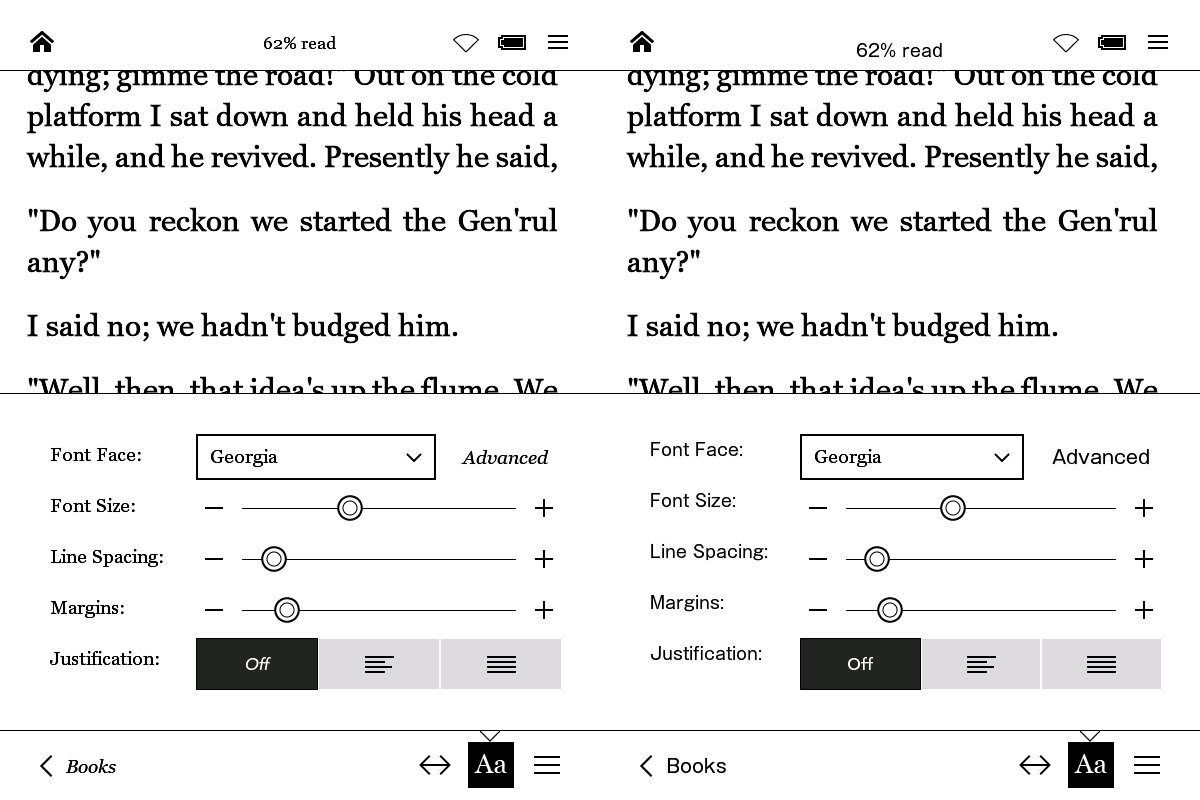

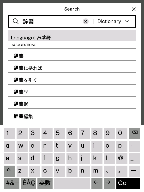

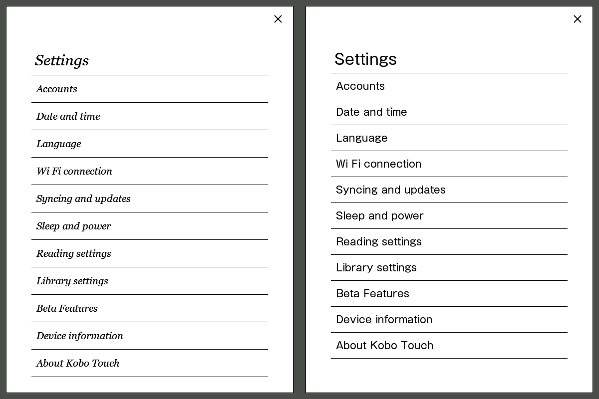

I upload some pictures that demonstrate the effect of this hack on the appearance of the GUI. The first three images show a comparison between the regular English GUI (left) and the modified Japanese GUI. The fourth image shows the Search in Dictionary screen with the Japanese dictionary selected. The display of the characters is less than perfect, but this is not related to the hack. The fifth image shows a full screen page of the dictionary.
ID:	141273   Click image for larger version
ID:	141274   Click image for larger version
ID:	141275   Click image for larger version
ID:	141276   Click image for larger version
