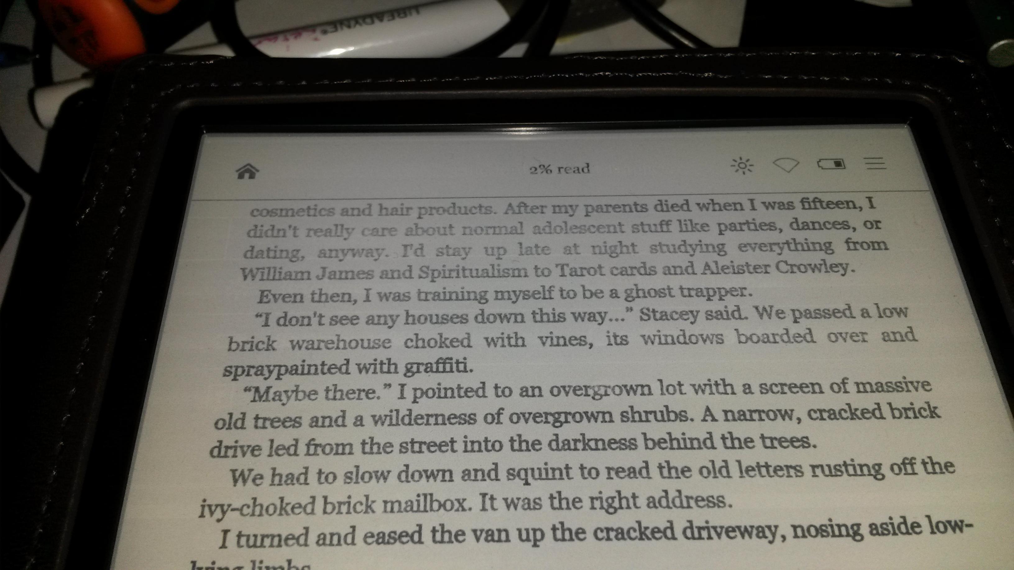

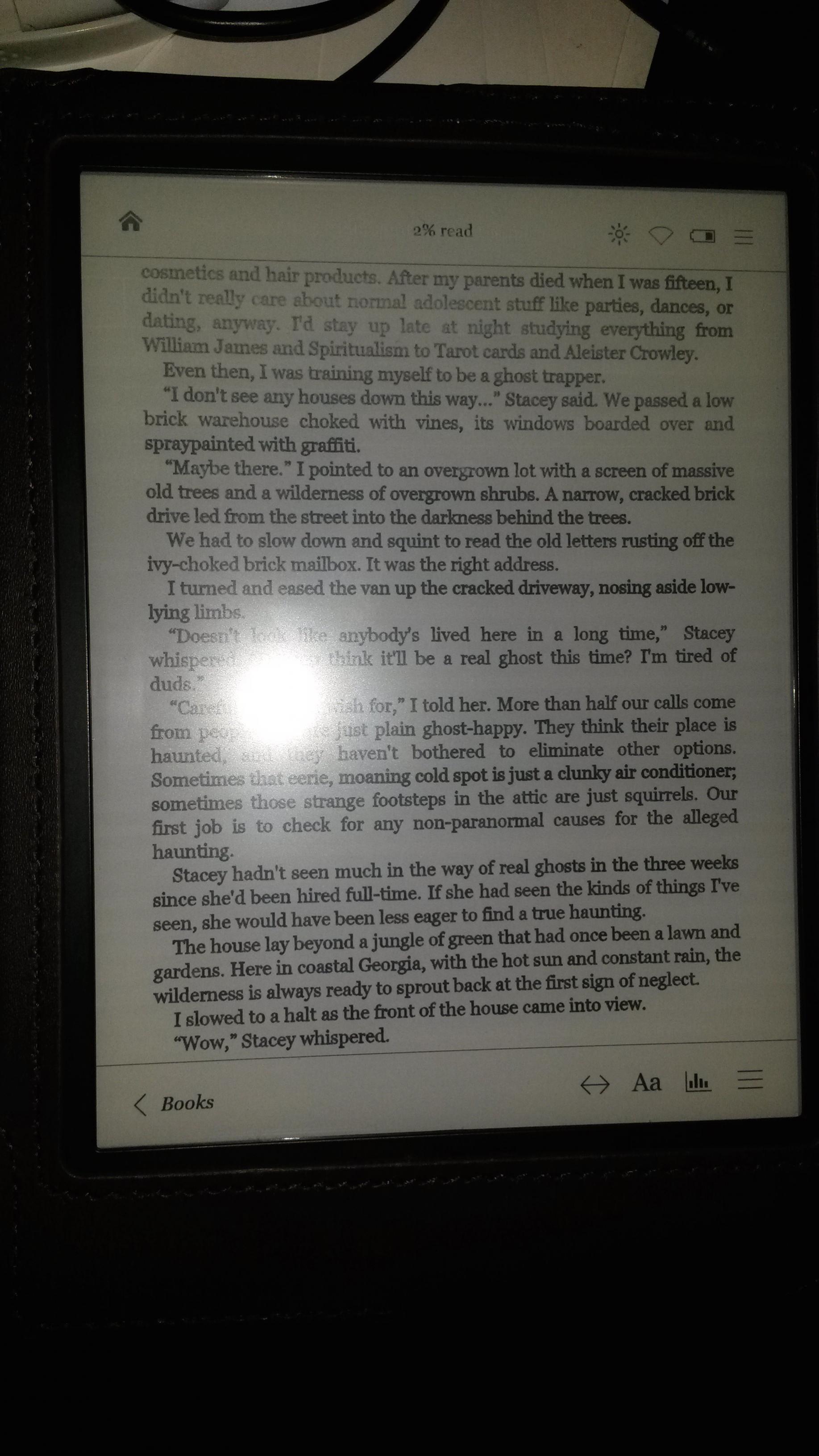

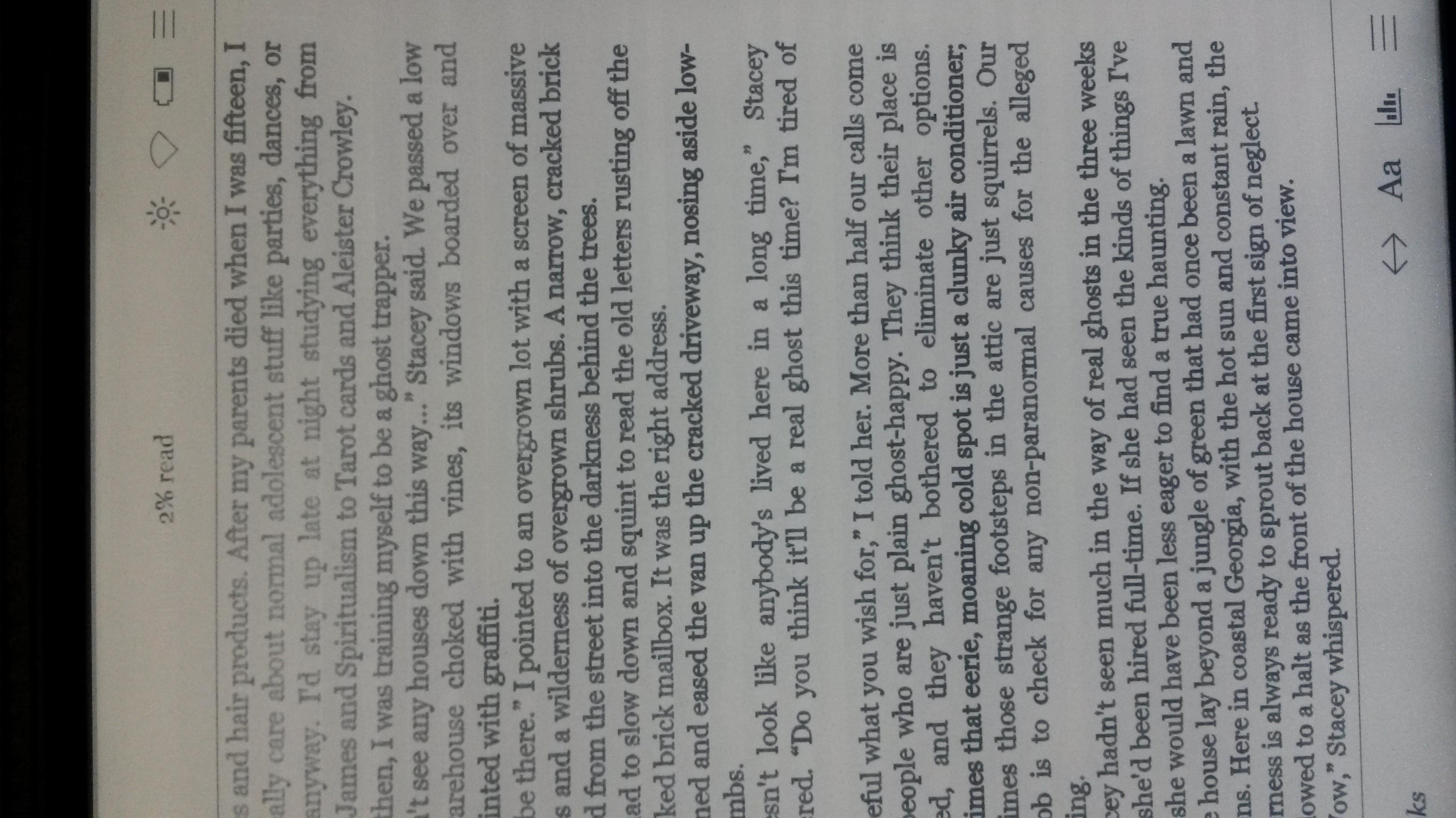

I'm getting ghosting from normal page turns on my Kobo Aura HD, a unit which I really like but one that I now choose not to read on due to this issue.
It's not unreadable, just disturbing and bothersome to me, enough so that I've retired it from active reading.
The black lines are horizontal and occur a bit slower during the page turn, as if it's a lingering afterimage. Maybe that's the best description: A kind of afterimage. This is extremely hard to explain. I have my refresh rate to change with every page turn, by the way. (My Kobo Glo does not exhibit this; that's my go-to epub reader and genre reader. My Kindle Paperwhite is for Literary works.)
I can only say that something is not quite right with my wonderful little 6.8 inch Kobo Aura HD.
In going forward (or backward), the letters are sometimes degraded, most often occurring in the top half of the screen.
If it's the video controller, is this a separate chip soldered onto the mother board?
Is there a video cable, one that could have come partly loose?
If you look closely, you can see the font degradation. The black, horizontal lines are barely visible [see second image], but extremely visible during the page turn.

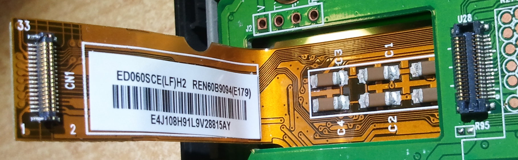

There is a [usually yellow/gold/flat] cable and you could pull it (very carefully) out of its socket and re-seat it, but it's not very likely that it'll help. There is some kind of controller chip and other elements baked into the cable itself, or that's how it is with most e-Ink devices.
Display errors can also happen due to ageing battery, there's a possibility the system itself will still run but the voltage not be what the display requires. I had this in my old Story HD and stopped occuring after replacing the battery. It almost looks like a broken display: stripes and very faint text. Basically display started drawing a new page but voltage or whatever was lost halfway.
Attachment is a Kobo Touch

The Aura HD uses a zif connector for the ribbon cable to the display.
Luck;
Ken
The black bar with the holes, lifts to release the ribbon cable, IIRC.
