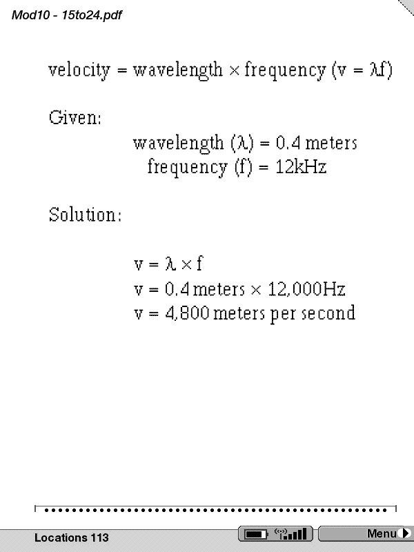

Here ya go. I'm posting several pages. There are quite a few more in the zip file.
Everything looks pretty good with the images but there were a couple rough spots with some Greek letters. Those images are at the end.

I have taken the liberty to download the file and import it into Mobipocket Desktop Reader and I get almost the same look you show in your images.
A good example is the wavelength definition - your 1-8a.gif file - and the rubbish at the end of the page is exactly the same:
GLVWDQFH EHWZHHQ $ DQG ( RU % DQG ) HWF LV RQH ZDYHOHQJWK 7KH *UHHN OHWWHU ODPEGD LV XVHG WR
So I would not disagree with bwaldron in that Amazon’s conversion mechanism is the same (or a very close similar) as the one used by the Mobipocket Desktop Reader.
Final: I do think it’s useless for these kinds of documents.

Well, except for the gibberish, it actually looks better than I expected. Thanks everyone for your help and input. It's kind of puzzling that the part where the conversion stumbles and creates gibberish looks (to me, anyway) like ordinary text in the original, where it looks like the graphics and images came out fairly well. Well, I did expect there to be trade offs in using any of these for pdf's. And it also sounds like there's no real difference in the quality between Amazon's process and Mobipocket's.
