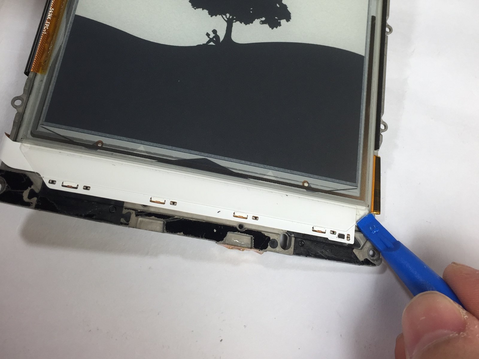

The sensor is on the right side of the Led strip. It is such a tiny black rectangle. Right next to the spatula in the photo. A bit higher than a typical smd resistor. Sometimes it breaks off when the front bezel is not properly disassembled.

The sensor is on the right side of the Led strip. It is such a tiny black rectangle. Right next to the finger in the photo. A bit higher than a typical smd resistor. Sometimes it breaks off when the front bezel is not properly disassembled.
Yep, double checked, and the sensor is in place and not damaged. I'm still thinking it's my dumb ass soldering over that resistor at the connector. I'll clean that up today and try again.
