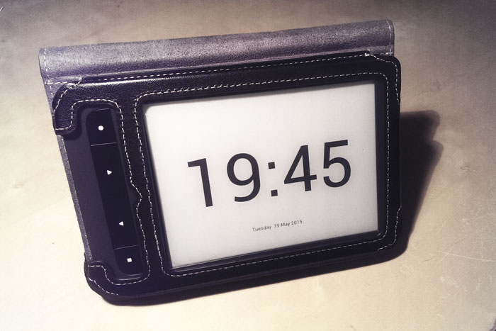

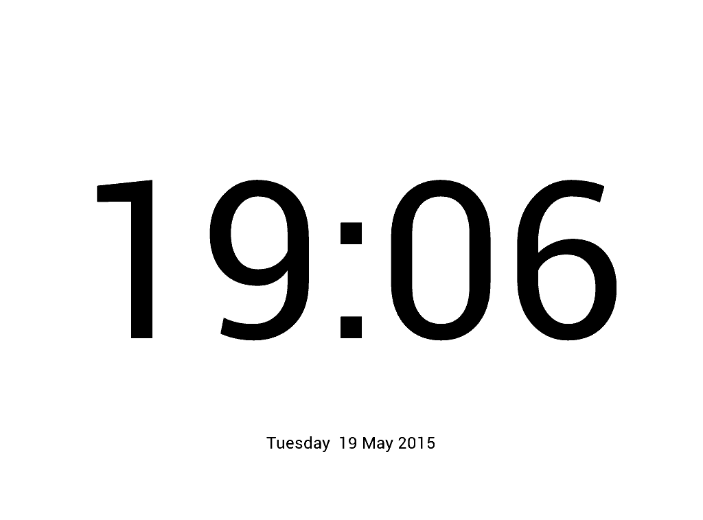

Hi,
I wanted to use my PB 626 with its long battery life and eink display as a simple night stand clock and didn't find anything usable.
There is Clocky available from http://fedorchenko.net/pb.php and the PocketBook free project website. It displays pretty terribly on my 626 though - half cut off.
I've based this on the clock sample code from the SDK 1.1, which did not start on my device due to missing resources in the current FW. I rewrote it to just use system fonts, display well and support all orientations. I intend to improve upon it and make it more modifiable and add an analog clock.
(Currently it will probably work well only with XGA (1024x768) screen devices, others will I believe break the text. I'll make it adjust properly when I get the time.)
So here it is, enjoy.

  • PocketBook 626 Touch Lux 3, fw W626.5.5.720

  • Inverted mode (sexy)
  • Frontlight switch by touch (thanks brucelee)
Working on
  • Frontlight intensity setting via swiping
