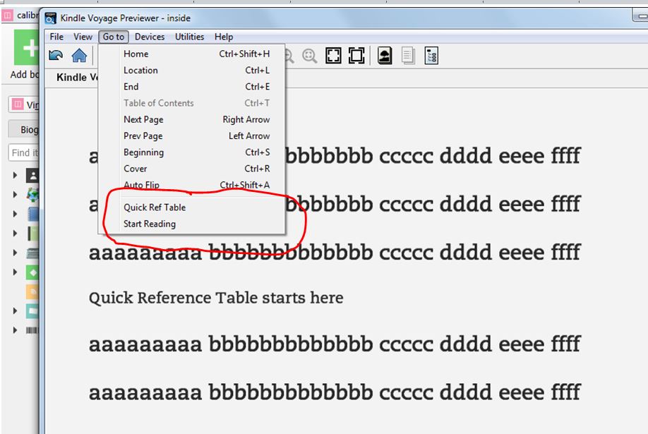

@eschwartz -- I think I must respectfully differ with you
Feel free to add custom semantics, but only you will know about them, because ereaders certainly won't.
If I edit the AWZ3 version by adding reference type="other.quickref", then it shows up in the Kindle reader under the GoTo menu
1. It seems if the ePub OPF contains this
<guide>
<reference type="text" title="Start Reading Here" href="start.xhtml"/>
<reference type="other.quickref" title="QuickRef Table" href="next.html#Table_of_Data"/>
</guide>
2. Converting to AZW3 generates this, but throws away the type="other"
  <guide>
    <reference type="text" href="text/part0000.html" title="Start Reading Here"/>
    <reference type="cover" href="images/00001.jpeg"/>
    <reference type="other.ms-coverimage-standard" href="images/00001.jpeg"/>
    <reference type="other.ms-coverimage" href="images/00001.jpeg"/>
  </guide>
3. If I manually add this to the guide section in the AZW3
<reference type="other.quickref" href="text/part0001.html#Table_of_Data" title="Quick Ref Table"/>
4. Then it shows up in the Kindle GoTo list (screen shot)
I really prefer to stay in the epub format for editing and convert if required (even if I had to enter type="other. " things manually)
It seems to me from my side of the keyboard, that the EPUB-to-AZW3 throws away the type="other" <guide> references.
It would be very handy if
a. The [Set Semantics] options would allow you to enter type="other.something"
b. The conversion process didn't throw such things away

Nope, try it on your Kindle -- doesn't work on my Kindle Touch.
Dunno why Kindle Previewer shows it -- must be a glitch.

@escwartz -- Nuts. I hadn't even gotten that far yet. It was just much easier to use the Kindle Previewer on the PC to see
The Previewer was showing as a Voyage, so maybe a Voyage is able to show

Let's hold off then, until we have some real-world devices that handle it. Then we can think about asking Kovid to preserve them when converting.
