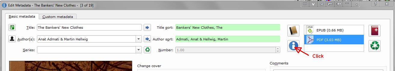

@iostrym - I need to apologise to both yourself and Tracker Systems. PDF XChange (free) does support XMP metadata - in the sense that it can display it. I didn't click enough buttons
I checked a number of my PDFs, and none have any dc:identifier elements - although they have other dc elements such as creator, language, title.
Try this - in Edit Metadata select the PDF format, and click Blue button, it does update other columns but as I don't have any PDF's with identifiers...

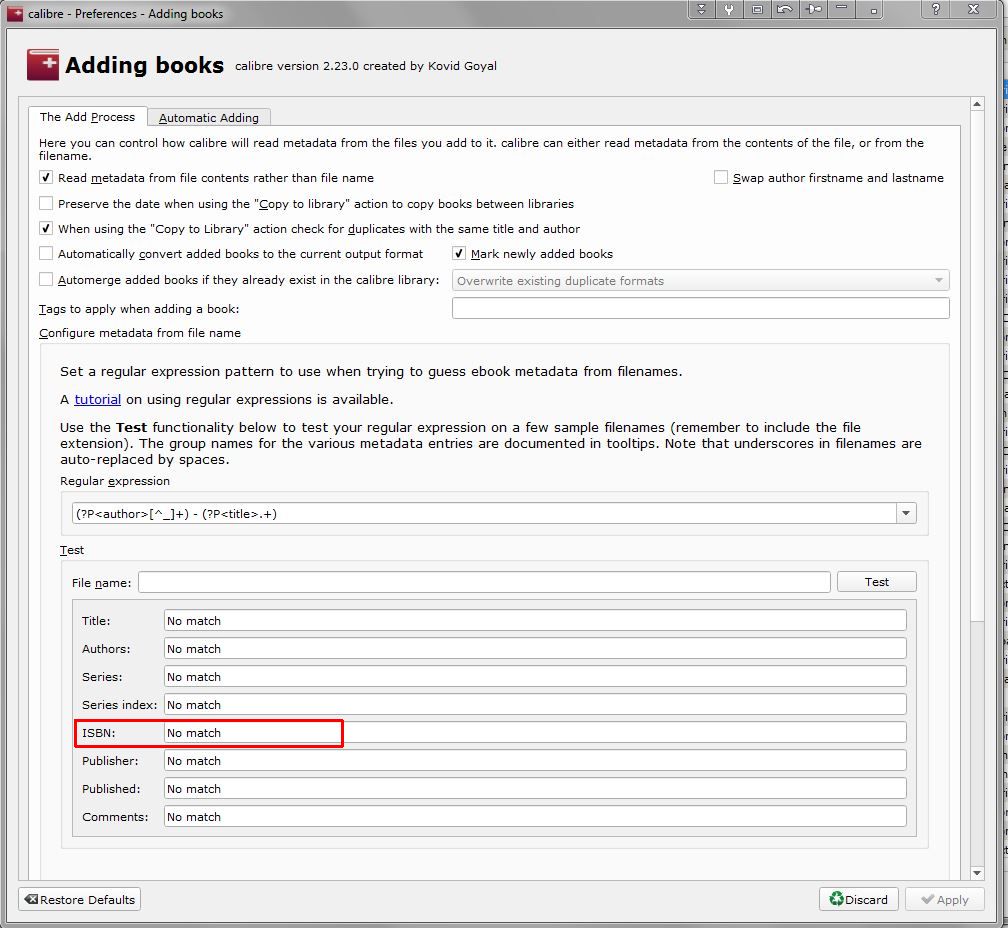

@iostrym - calibre has a vast array options so its impossible to remember them all, even Kovid Goyal sometimes misremembers or forgets something.
I just discovered that if you're prepared to put the version number in the file name then you can probably put it in the isbn number without using Bulk S&R
