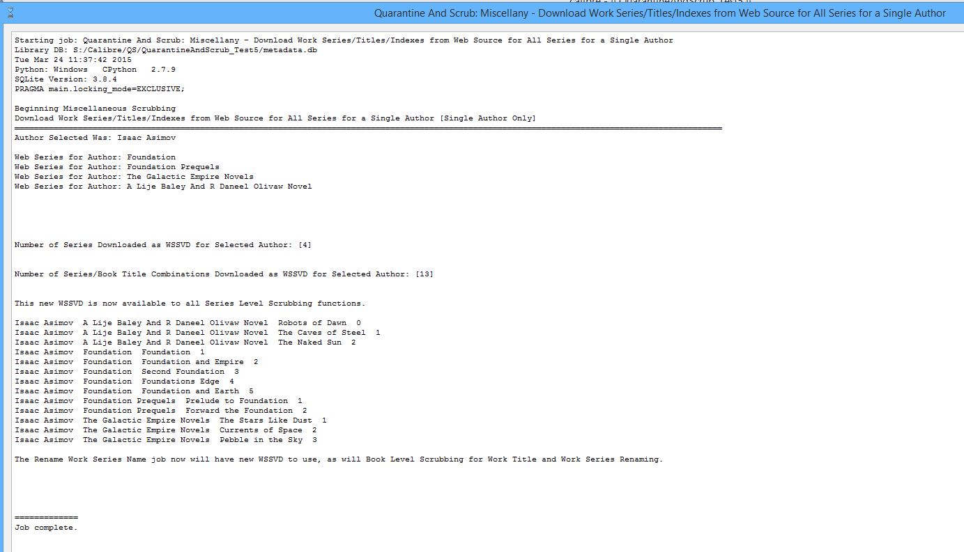

@bookrbt:
See the attached image. Version 3.6.53 of Q&S added this feature. The Q&S Series-Level Scrubbing/Renaming functions use this downloaded data that is kept permanently for future use by Q&S to automatically fix incorrect Titles, Series and Indexes. If the Series and Index are missing, it automatically adds them.
https://www.mobileread.com/forums/sho...d.php?t=247425
