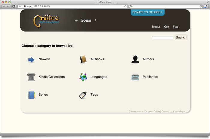

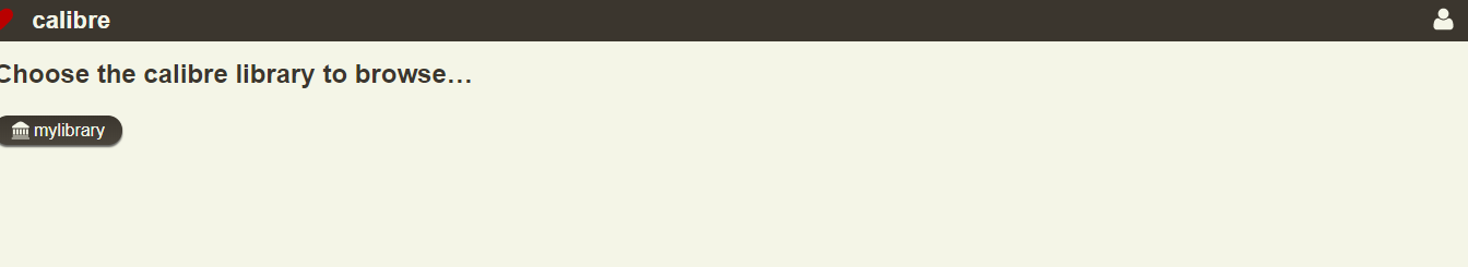

When I look up calibre in the web browser I get this:
Please see installed.png attachment
[IMG]installed.png[/IMG]
However, I should see something like this:
Please see normal.png attachment
[IMG]normal.png[/IMG]
I can only list the books, and search among them, but can't add categories for example. It's like most of the functionalities are missing.

You are comapring a screen shot of calibre v2 with v3, they are different. As for you read book issue, try a different browser, see the browser support section in https://manual.calibre-ebook.com/server.html

And 3 has far more features than 2, they are just organized differently.

Could you please tell me, the attached image is which version of calibre? 2 or 3? (I hope it's 3 )

It's 3 (the server in 2 has no ability to read books at all, only download them).
