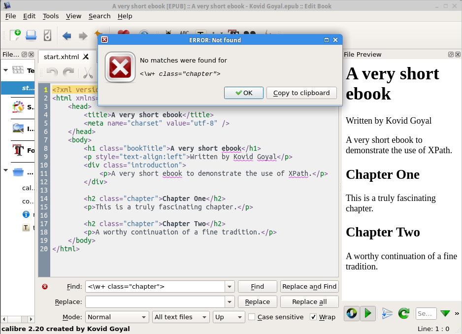

The Sample ebook says: A very short ebook to demonstrate the use of XPath.
How can I let this 'Very short ebook' demonstrate me the use of XPath?
No matter what search term // h: h2 or // * [@ class = "chapter"] or <h2( [^>]*)?> or <\w+ class="chapter"> the result is: No matches were found for ...
That specific question needs more a practical answer.

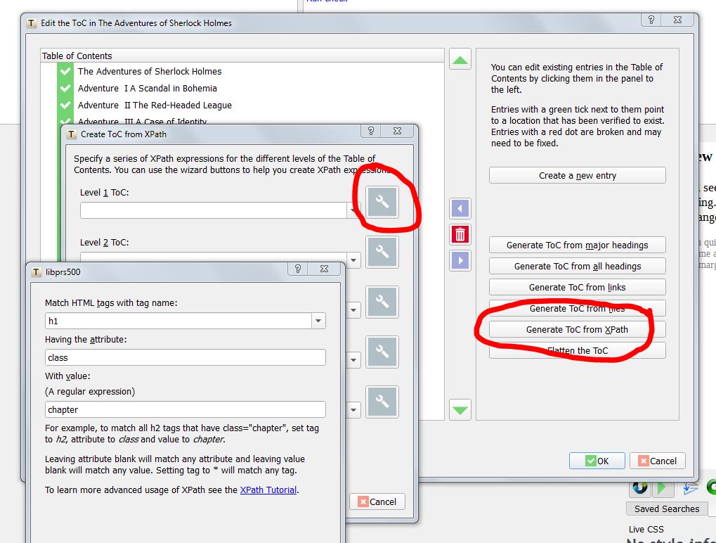

You don't use the XPATH settings in the regular search area.
Try clicking on Tools | Table of Contents | Edit Table of Contents and then there is a button Generate ToC from XPath

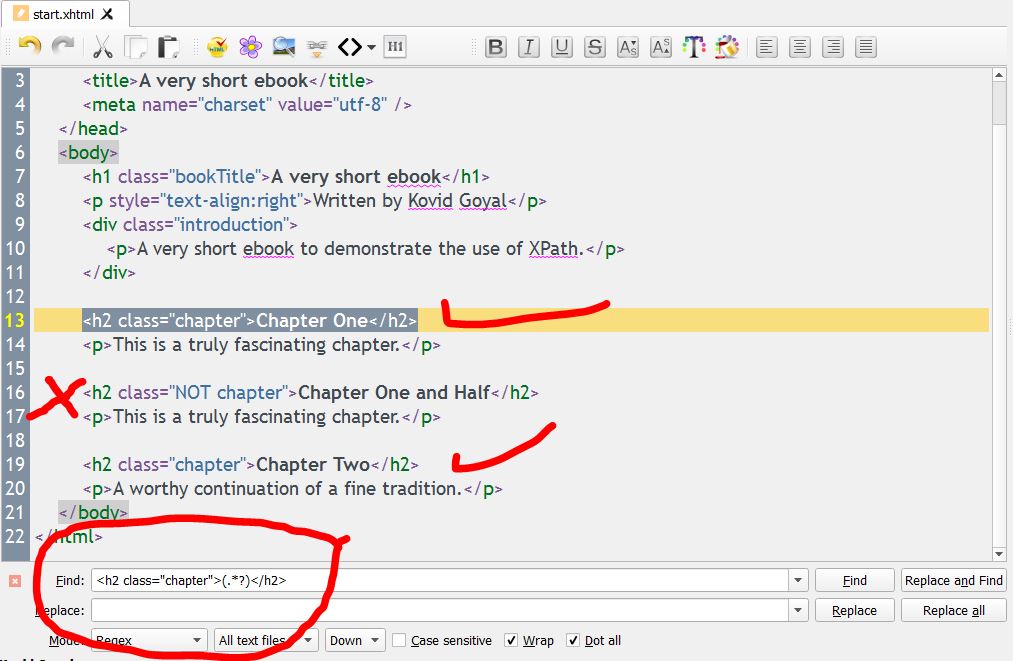

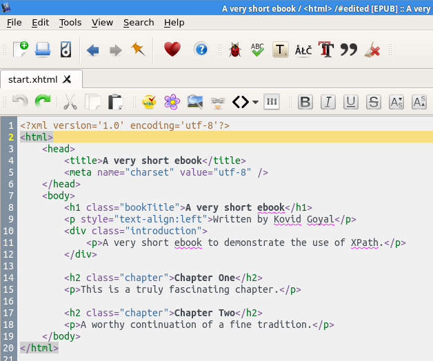

XPath has some other uses, but all I've used it for is making table of contents (screen shot)
In the F&R you can only use Regular Expressions
http://manual.calibre-ebook.com/regexp.html
Using eschwartz's RE you can find H2's with class="chapter" in the sample book (pic 2)

@chaot -- as PeterT said.
And the regex did not work because you were in normal mode, not regex mode. The S&R can take regexes, like the translation I supplied, if treated correctly. xpath is totally different.

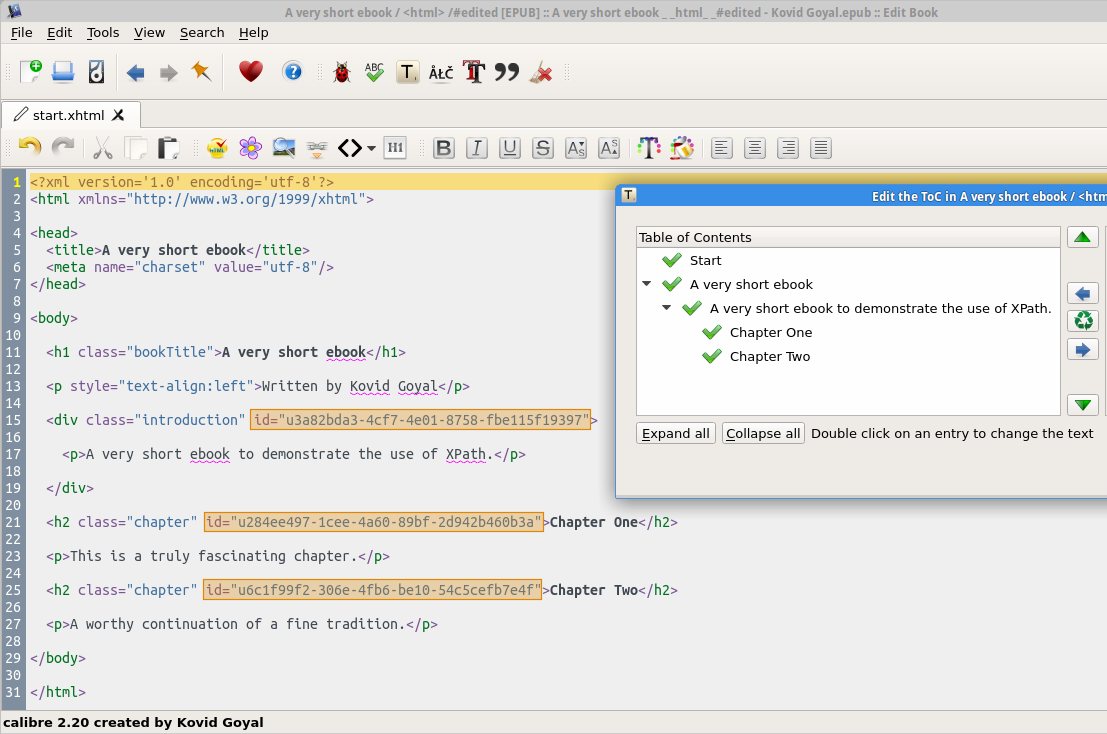

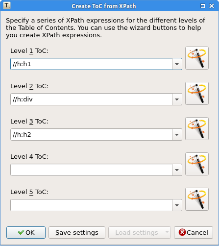

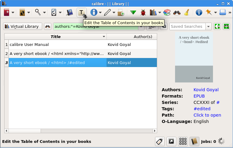

The original to start with, see A very short ebook.
Or just use the button ToC (see Button-Edit the Table of Contents). But this button (from general calibre window) is more for to see the ToC than to edit, even so possible.
So you are quite right to mention the 'path': without Edit book window we wouldn't know the correct 'key phrases' to use (see Edit the ToC in ... (Start) after Fix HTML + Beautify current file)
In a (very) small ebook creating the ToC its enough to fill the libprs500 window only HTML tags with tag names (like a, br, div, h1, h2 etc.) and ignore the attribute and value inputs. That's probably in bigger ebooks not to ignore in order to obtain a really sophisticated ToC (at moment I don't know).
Here results the same if using only //h:h1 or (full expression) //h:h1[re:test(@class, "bookTitle", "i")] - tested.
See Create ToC from XPath and the result Edit the ToC in ...(vers A).
Note: The HTML tags div and h2 get id-numbers (both h2 different ones), but the HTML tag h1 gets none. Can you say something about?

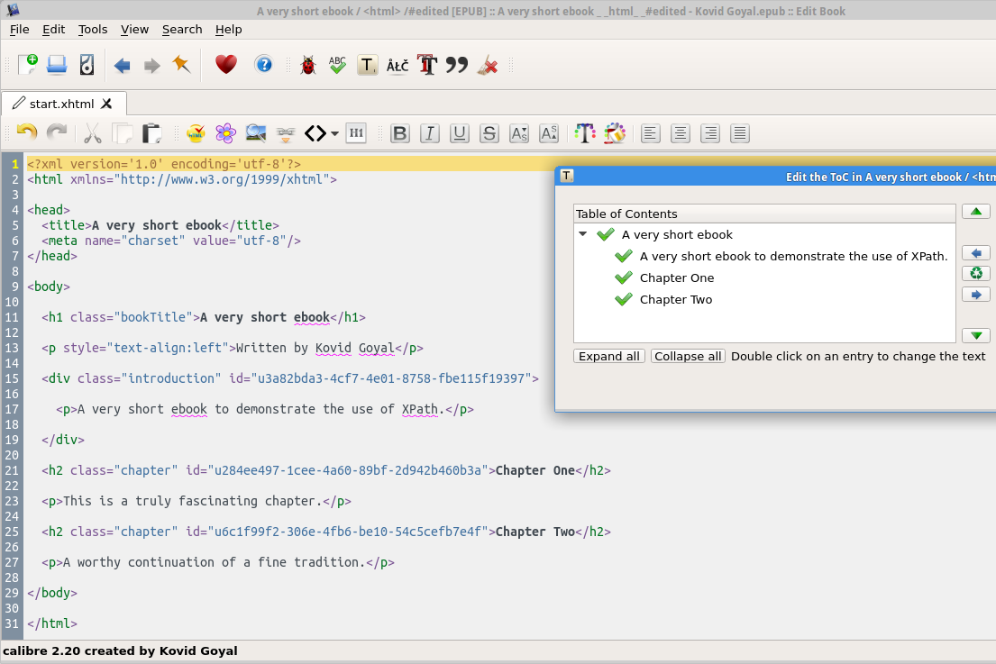

It's possible to customize the ToC, see Edit the ToC in ...(vers B)
