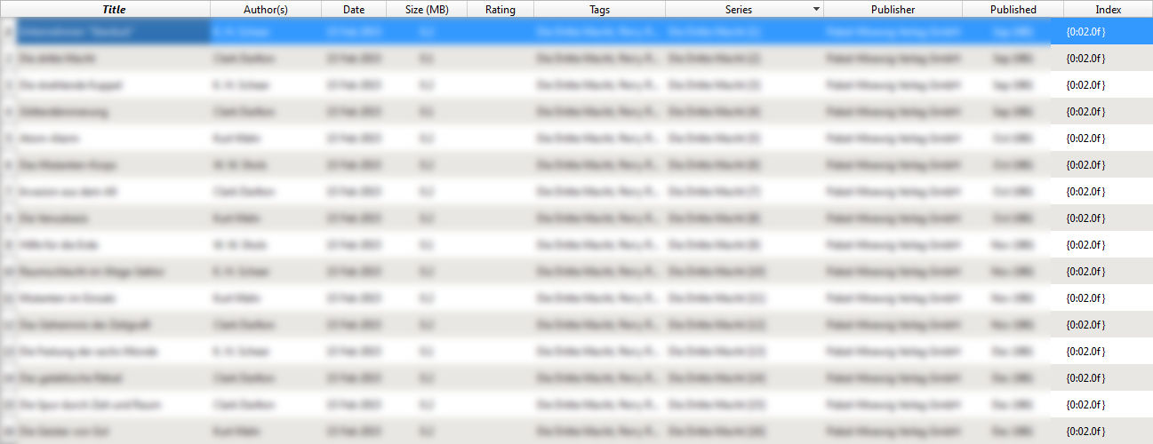

Hi eschwartz. Ok. But what I get instead of "0001" or "0456" ist this (see screenshot).
Did I do something wrong?
st.

Sry. Here it is.

Sorry for the confusion -- this script creates a custom column that contains a formatter, you still use the series_index.
For instance:
program:
new_series_index = format_number(
	field('series_index'),
	field('#format_series')
@BR -- chaley made this, and I assume used this method since it allows one to change the series_index info to a limited extent without requiring a rebuild.
