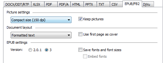

Question ABBYY forces me to use reduced image quality
On this dialog, whenever I change any of the settings, if I go back to the dialog they've all been reverted to the default (and the defaults is that of reducing images to 150 DPI). That the EPUB is not assuming the higher quality image settings is apparent in the saved file. Now, if I change that option of EPUB version 2.0.1/EPUB v. 3.0, that sticks. If I revisit the dialog, the last thing I had chnaged it to is still set.
I actually have habit of revisiting dialogs after i change settings. Just to make sure that such changes were made. My redundant habit has come in handy this time. Every time I use ABBYY FineReader, I've suspected that my image quality settings are not saving. Now that I saw the stark contrast between the original PDF version of particular cover image and the ABBYY EPUB version, it's apparent that ABBYY is discreetly rejecting my specifications for some reason.

1. ePUB output from ABBYY is mediocre at best. The scan will have various OCR results and will make a mess out of the styles.
2. You can always save the output also as HTML with images at best quality and then replace the images in the ePUB with these images.
I have noticed this also happening on the latest version of Finereader 12 (12.0.101.382). I believe this bug began occurring after the latest patch, because it was DEFINITELY working properly when I first purchased 12 (and I had zero problems with this in Finereader 11).
I will have to gather a little bit more intel/testing, and I will submit a bug report to ABBYY.
I only noticed this in the EPUB export (because that is what I use), although it may be effecting some of the other formats.
Originally Posted by u238110 View Post
And if I went with your option, what would be the most efficient way to go about doing that? I know that Calibre's editor displays all the images in a book in a list... How does one update an image by replacing it with a different version?
Hmmm, well to get around this bug, I do what Toxaris said.
I export the EPUB version (this has that 150dpi bug), and then I export an HTML version (images set to "source quality"). I then plop in the HTML images into the EPUB using 7-zip (or any zipping program), and then edit the EPUB using Sigil to remove the height="###" and width="###" from the <img> tags.
