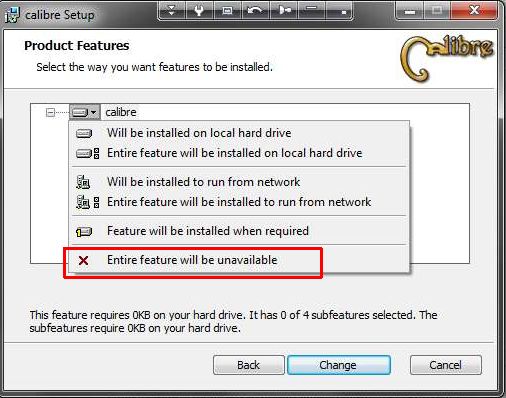

I think I've figured out what was causing the mismatch. When updating to version 2.12 I selected Advanced on the install, primarily to check the location of the install was set correctly; it was. However on the next screen where the options to select the components is, none of the components was selected by default.
By clicking on the top option and selecting "run all from computer", it selects the four options below.
I'm now successfully updated. Hope that helps anyone else having the same issues.
@MetalOllie - thanks for letting us know you figured out what was happening. Are you saying the Features dialogue looked like this:
If so, that's bizarre, because that either means someone did this
Name:	Screenshot - 2014-11-30 , 10_27_15.jpg
or something/one scribbled on the relevant registry values.
I'd never clicked in the top drop down in the features dialogue before now. I wonder if this explains ArgentSun's problem.
By default the 'Trusted Installer' (msiexec) will use the settings from previous installs. If the install on demand option was 'set' msiexec.exe may want to compare the last download with the one being installed, to see if any new features were added or existing ones removed. - hence it was asking for the 2.9.msi.
That's a better rationale for storing the location of the last used .msi file in registry than my previous theory that it was only there to populate the Source column (which isn't normally displayed) of the Programs and Features list
Network and install on demand options are frequently used in corporate environments that manage their desktop environments centrally, often in conjunction with tools such as SMS and Tivoli.

Hi BetterRed..
Yes, that's exactly what the menu looked like. Apologies for not having had the time to screenshot it myself, but hopefully with my info and your screenshots the problem can be resolved.
