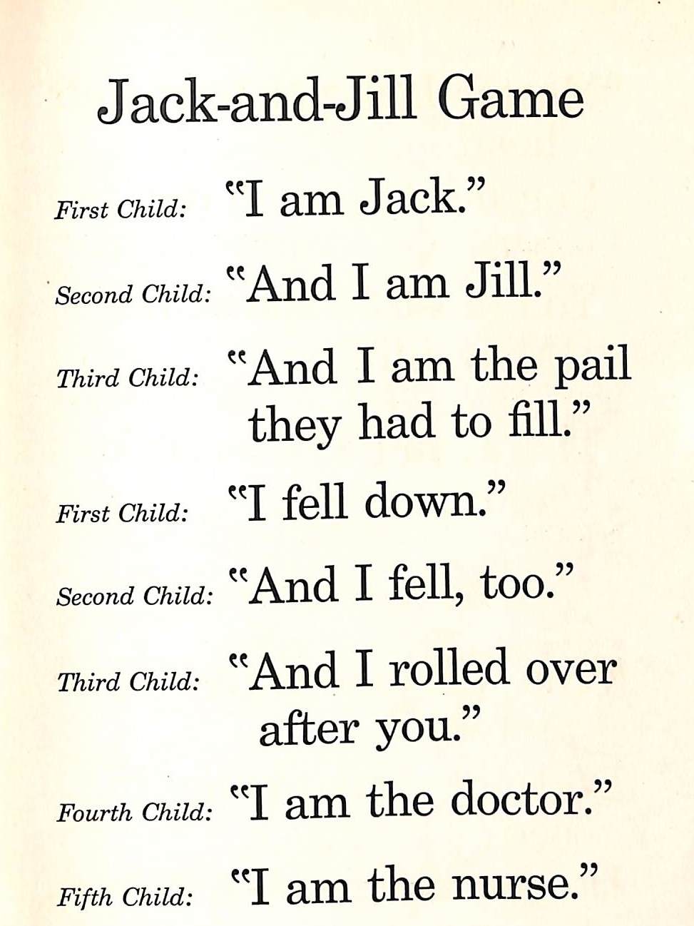

Hello,
I am working on a book with speaking parts
On the left are the names of the characters in one type of font and italics
On the right are the lines of the character. They are a different font and bold.
The issue is dealing with the spacing. The words on the right are all evenly indented from the far left. I am including a pic of one page so you can see what I mean. Any suggestions on how to do this would be appreciated.
I am thinking about a table with no border around it.
Or should I just use the css to style the two different font and margins?

I think table is a good option, if you use CSS then it can get screwed if user changes the font size.

The only way I know how do tables is:
<table style="width:100%">
<tr>
<td>xxx</td>
<td>xxx</td>
</tr>
<tr>
<td>xxx</td>
<td>xxx</td>
</tr>
</table>
</body>
</html>
Some concerns:
1) the width will look weird if there is only one or two words by the character...other times there may be two sentences.
2) Are tables subject to the readers font-size increase? If so, how do they not totally wreck the layout of the table if it can't fit on their display at larger font sizes.
Is there a better way to do all this?

I wouldn't try to reproduce that layout, it gets ugly in narrow screens. I'd rather go for something like:
First child
"I am Jack."
Second child
"And I am Jill."
<p><span class="speaker">First child</span>"I am Jack."</p>
<p><span class="speaker">Second child</span>"And I am Jill."</p>
p { margin: 1em 0; }
span.speaker {
  display: block;
  text-align: left;
  font-size: 80%,
  font-style: italic;

Ok, I tried your code and got it to work.
I am confused a bit though. With only the two <p> tags, how did I end up with four lines?
I understand that the <span> tells the file do something different to what is encased between the span, from what should be done to the normal <p>, but what told it to start a new line? From experiment it is the
display: block
but I am not sure what that all means

If you use a table, you should add a blank cell between speaker and speach, so you get some space between the cells. Like
<tr>
<td>First child:</td>
<td>&nbsp;</td>
<td>"I am Jack."</td>
</tr>
In another thread it was recommended to make each row a single table to avoid a possible break of the table at a page-break.
I think, you don't need table-width="100%", because the text takes the space it needs and widens the table if necessary instead of a line-break.
In css you could get a table-like layout with:
<head>
<style type="text/css">
p.speaker {
text-align: left;
margin-bottom: -1.25em;
font-size: 1em;
font-style: italic;
text-indent: 0em;
p.speach {
margin-top: -1.25em;
margin-bottom: -1em;
margin-left: 8em;
font-size: 1em;
text-indent: 0em;
</style>
</head>
<body>
<p class="speaker">First child:</p>
<p class="speach">"I am Jack."</p>
<p class="speaker">Second child:</p>
<p class="speach">"And I am Jill."</p>
</body>
I think, it looks fine, though it might be a little tricky with the margins.

You might like to have a look at Aristophanes and War by Aristophanes, and The Trojan Women by Euripides in the MobileRead library. The character names in these plays are in small capitals, which I think makes them stand out from the text they speak with rather less markup than the suggestions made so far. I suppose a lot depends on how many times you have to identify the characters.

What you could do is use <dt> and <dd> tags and style those. That would eliminate the need for those pesky tables.

There are two basic display types in CSS/HTML: block and inline. Block elements force a linebreak before and after, and take all the available width. Inline elements do not introduce linebreaks and keep their natural width.
By default, elements like <p>, <div>, <blockquote>, <h1>... are block, and <i>, <strong>, <a>, <img>, <span>... are inline. But the "display" property can change that.
Actually, I could have used <div> instead of <span>, and removed the "display: block", but there is a rule that <p> cannot contain default-block elements, so I'd have to put the <div> outside <p>, and it starts to be messy.
