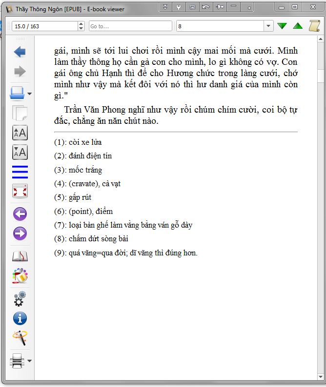

Which footnote is causing the problem? I tried clicking (8) and (9) and they both worked. See screenshot.

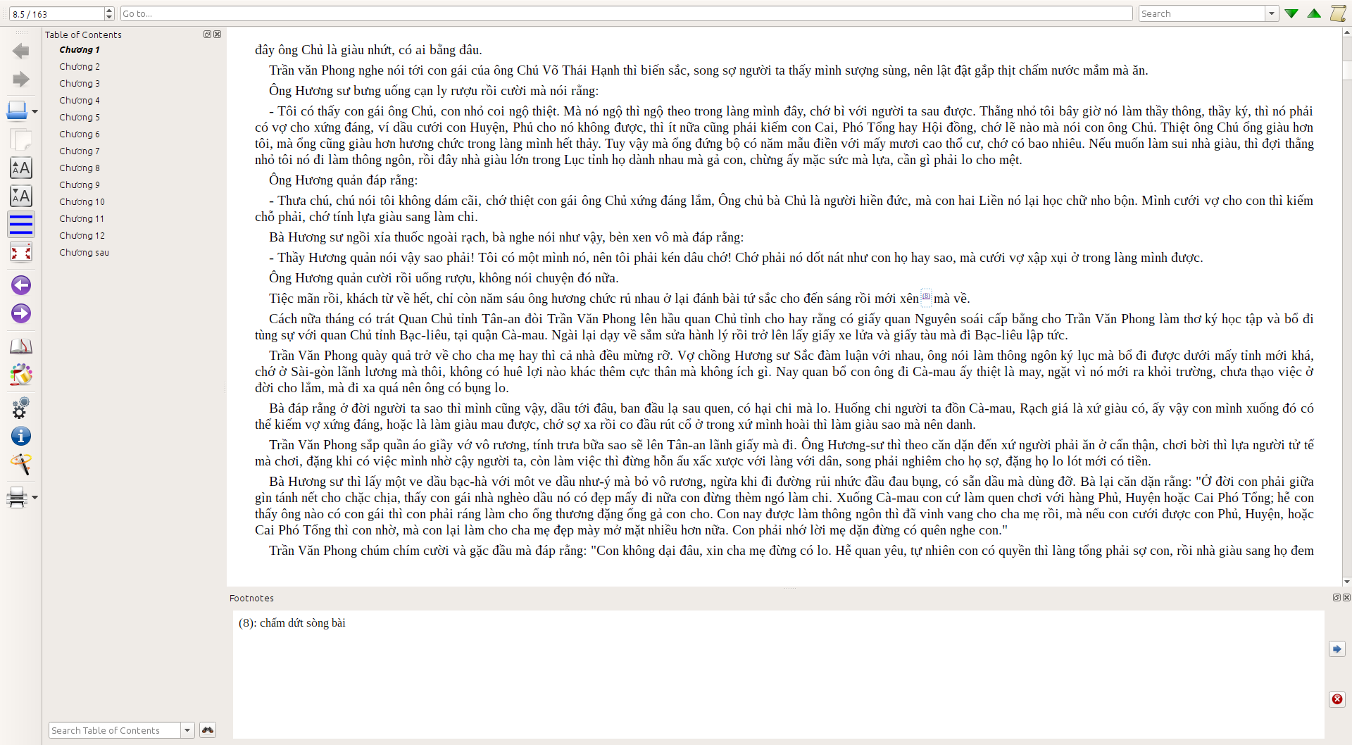

Kovid - fresh install of 2.9 portable with default settings
The EPUB from nqk doesn't work for me either, I get taken to end of chapter when I click ref number, e.g. 8 or 9. I see no footnotes panel. And the viewer is not 'remembering' the window size, but it is 'remembering' text/background colour changes
It's hasn't worked in the installed version on my books, but I've been assuming the links were badly formed. I've not followed it up is because the release notes said 'popups' and I hate popups - your screendhot shows a dockable (I think) panel which is exactly what I prefer
