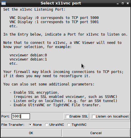

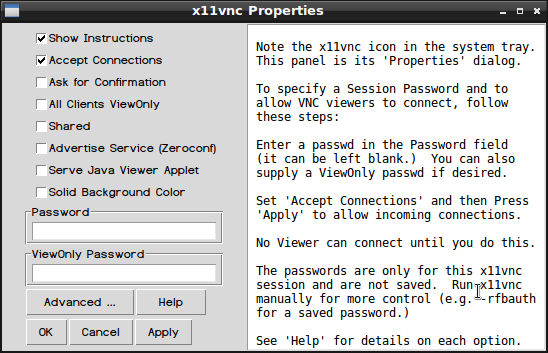

The command "ip addr" appear this:
inet 192.168.15.201/24 brd 192.168.15.255 scope global usb0
This is my configuration VNC server

So.... run "./luajit vncviewer.lua 192.168.15.201:1"?
Configuring x11vnc can get quite complex. See "x11vnc --help" for what I mean...
