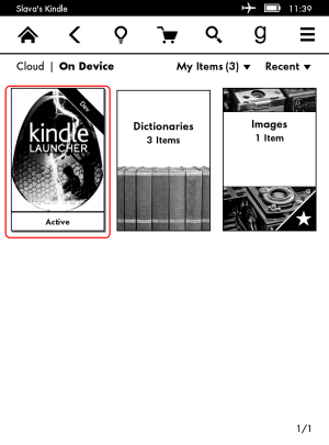

3) Next, you need to consistently click on those highlighted in red in the screenshots:
Run the “Kindle launcher” from the main program window.
Choose “Kindle Menu” from a list of buttons.

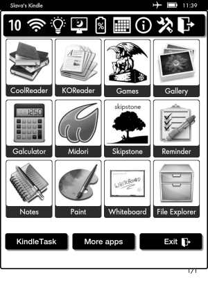

After the side we can see an alternative menu. The line with the quick
launch icons is highlighted in red.
