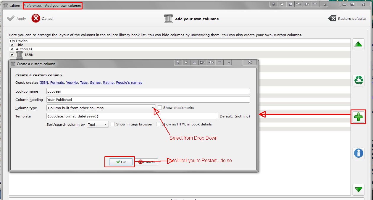

Old 10-09-2014, 07:58 PM   #11
Posts: 22,044
Karma: 30277960
Originally Posted by millan View Post
Thank you all again.
I think I'll be able to start doing it.
Would you please tell me how to get to the interface for the below point please:
Create a new custom column "built from other columns"
@millan - see attachment
Old 10-10-2014, 01:05 AM   #12
millan
millan began at the beginning.
millan's Avatar
Posts: 35
Join Date: Oct 2014
Thank you the perfect visual, BetterRed
All the best from an ex Sydney, NSW Resident
