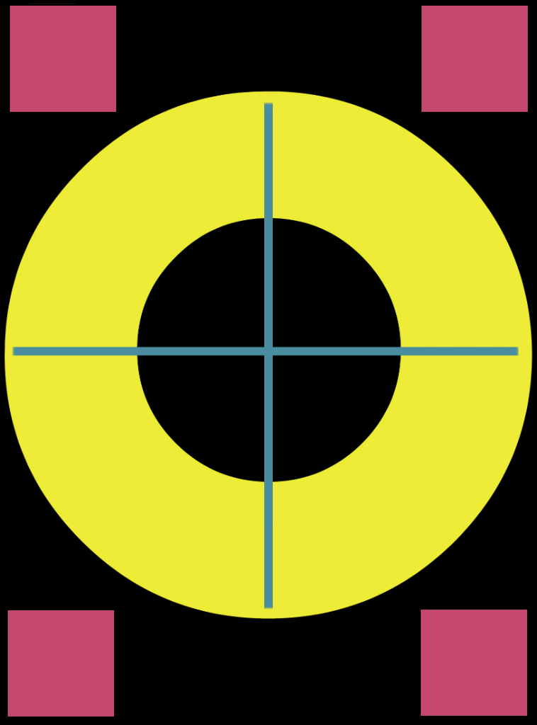

It doesn't matter, Sony always stretches the cover in standby-mode because the cover gets then a left and right white-border. The only way to get it in the right size is to forget about aspect ratio, then the cover will be stretched to full size in standby-mode and the cover is actually the right size. Problem is only that then the cover is stretched in the book.
I even made me a test cover to better see the result. The lines in the circle have the same length and the squares are exactly 150 to 150 pixel.
Any more ideas?
Mini

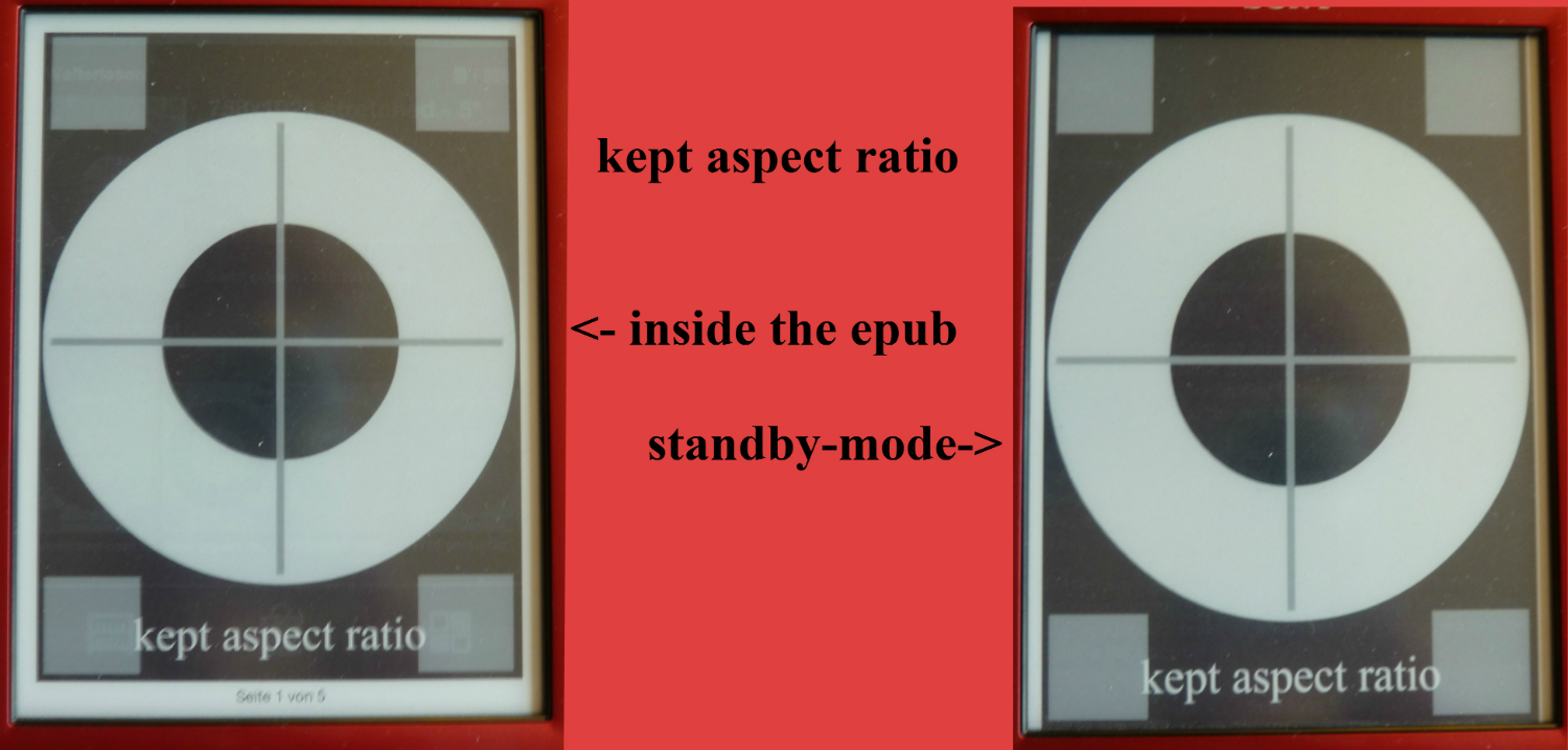

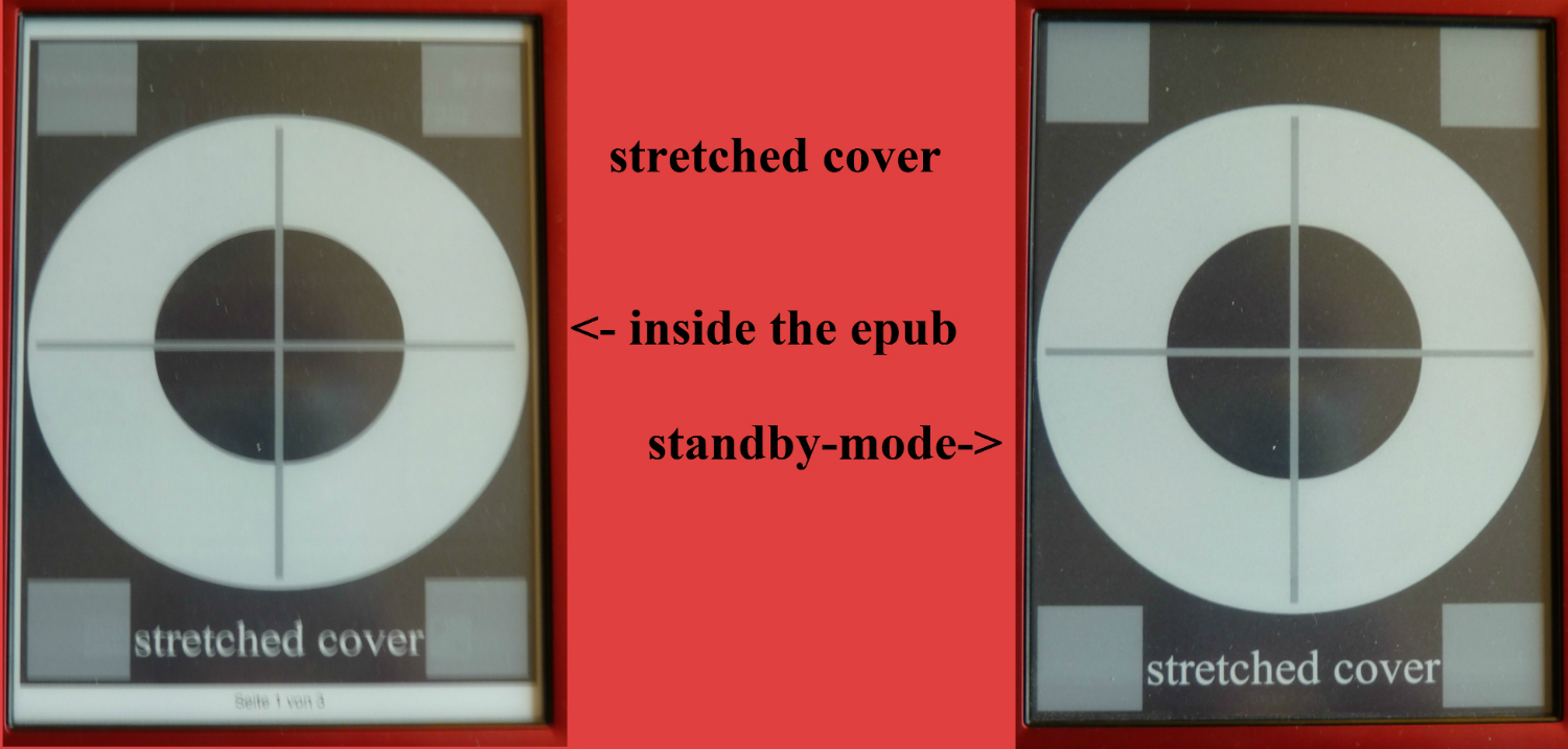

Here are pictures, not the best (a bit blury) but I think you get the idea AND the test-epubs.
Like I said I wouldn't bother with the cover size if I didn't want to start them making even wider for my tablet and was thinking about slicing the cover left and right in SVG (and that doesn't work with the strange behavior of Sony im standby-mode).
And by now it is bothering me why Sony does that at all... I make a lot of covers and I don't like them getting deformed!
Mini

Indeed, the stretched cover looks more "stable"...
Ghitulescu is offline   Reply With Quote

I found the thumbnails on my reader and they look fine (though very small and hard to see) but I found no way to change anything.
I set my epub conversion by now to Sony T3 (what I didn't have before), I tried tablet (because someone said then there would be no resizing of the image) - all of that changed the viewbox and image settings but NOTHING changed the outcome! When on standby-mode (with kept aspect ratio) the epub's first side image has a left and right white margin and gets stretched!
I even checked a book that was pre-installed on the reader, same result (meaning stretched cover in standby-mode again)!
What I don't understand why you don't have the problem on your reader? At least with my epubs the result should be the same, if not that means that the problem is not with my epub but with my reader. I have two T3 and I tested with both and they both have the same isue!
I'm ad a loss...
I know that the problem is not there when I use a concret image as standby, only when I choose the last read title of the book as image.
I think I have to live with stretching the covers.
Thanks for your help anyway.
Mini
