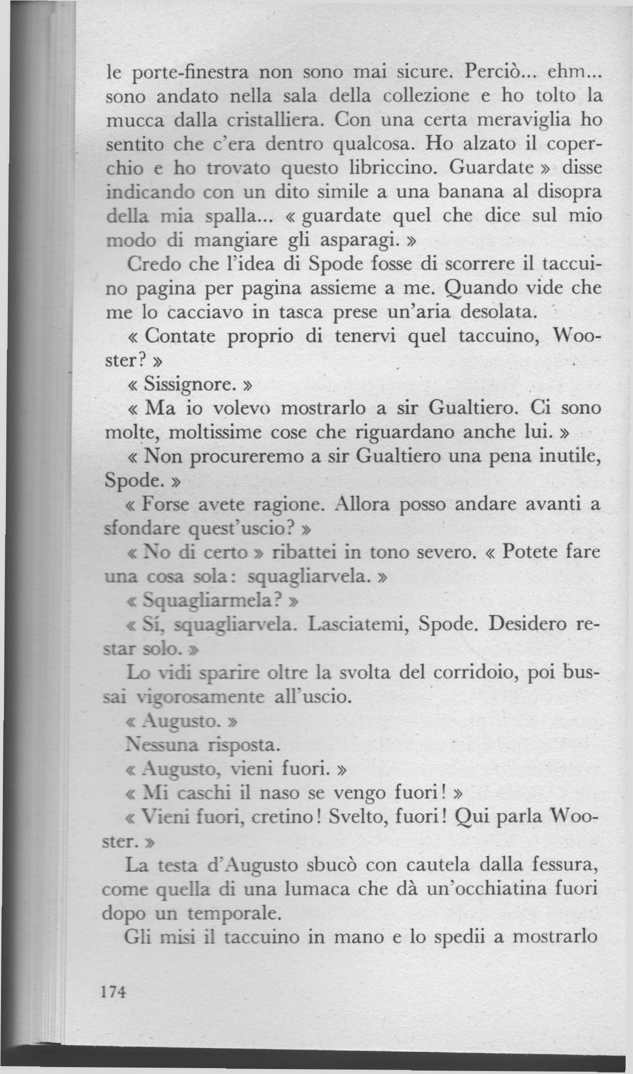

Hello everyone.
Little issue with AFR.
Sometimes the ocr doesn't read the line break after the « guillemets »
See attachment for an example of a page where this happens.
I can fix part of the problem with perfect epub, by breaking the line between a closing and an opening guillemet (do you really use this word?), line this, » « , but I can't seem to find a solution for where the new line starts with a normal uppercase letter. I also can't use a regex to find all the instances of closing g. and uppercase letter, because many times that's the way it is on the text as well.
Any ideas?
TY

Well I don't know. It doesn't make too much sense that it should place two words one next to the other when in the book the line breaks at 1/2 lenght and the following one starts with an indent.
I found that Finereader 12 has gotten WORSE in this situation than Finereader 11 (or, it could just be the specific books I have been working on lately, or maybe it is just my mind playing tricks on me).
As you mentioned, you already caught the real easy situation. You can easily just search for "closing + SPACE + opening":
Search: ” “
Replace: ”</p> <p>“
But the situation with normal text with no opening quote..... there is really not not much you can really do besides just doing an A/B comparison.
I almost exclusively work on non-fiction books, but the handful of fiction books I have converted made me want to pull my hair out because of this error. I have to spend too much time double-checking the work, than the quick scan through I can do in non-fiction (because of MUCH larger paragraphs).

That is where my add-in comes in handy I guess. You can just enter the S/R rules you need and execute them (besides the other functions).

@Tex2002ans. I'm using AFR11, and I think it happens only with this kind of quot. marks.
@Toxaris I'll check your add on. Unfortunately though, I'm pretty sure it can only help that much, because not every time it is an OCR error.
