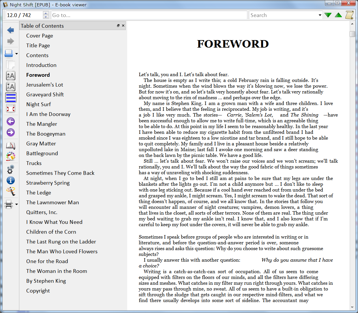

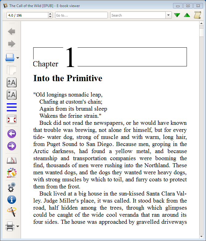

Today I've updated to Calibre version 2.0. While putting some books into shape, I've noticed that the lines were all out of sorts. They lost their justification on the right, and now display ragged. It comes down to using Hyphenate This, which is a plugin that puts soft hyphens into the text. See the attachments:
soft_hyphens_none.png: without soft hyphens
soft_hyphens_yes.png: with soft hyphens
After putting in the soft hyphens, the lines get out of wack, and get justified properly when removing the hyphens. I'm seeing this issue in both the Calibre Viewer, and the Ebook Editor, and with all books I've tested (all EPUB).
If necessary, I could return to version 1.48 to test and be 100% sure, but I'm quite certain I've never seen this before.

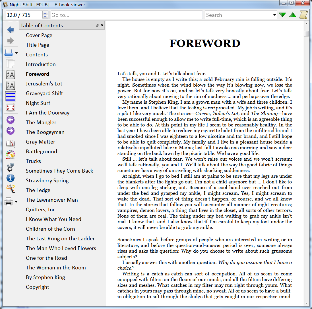

Here you go

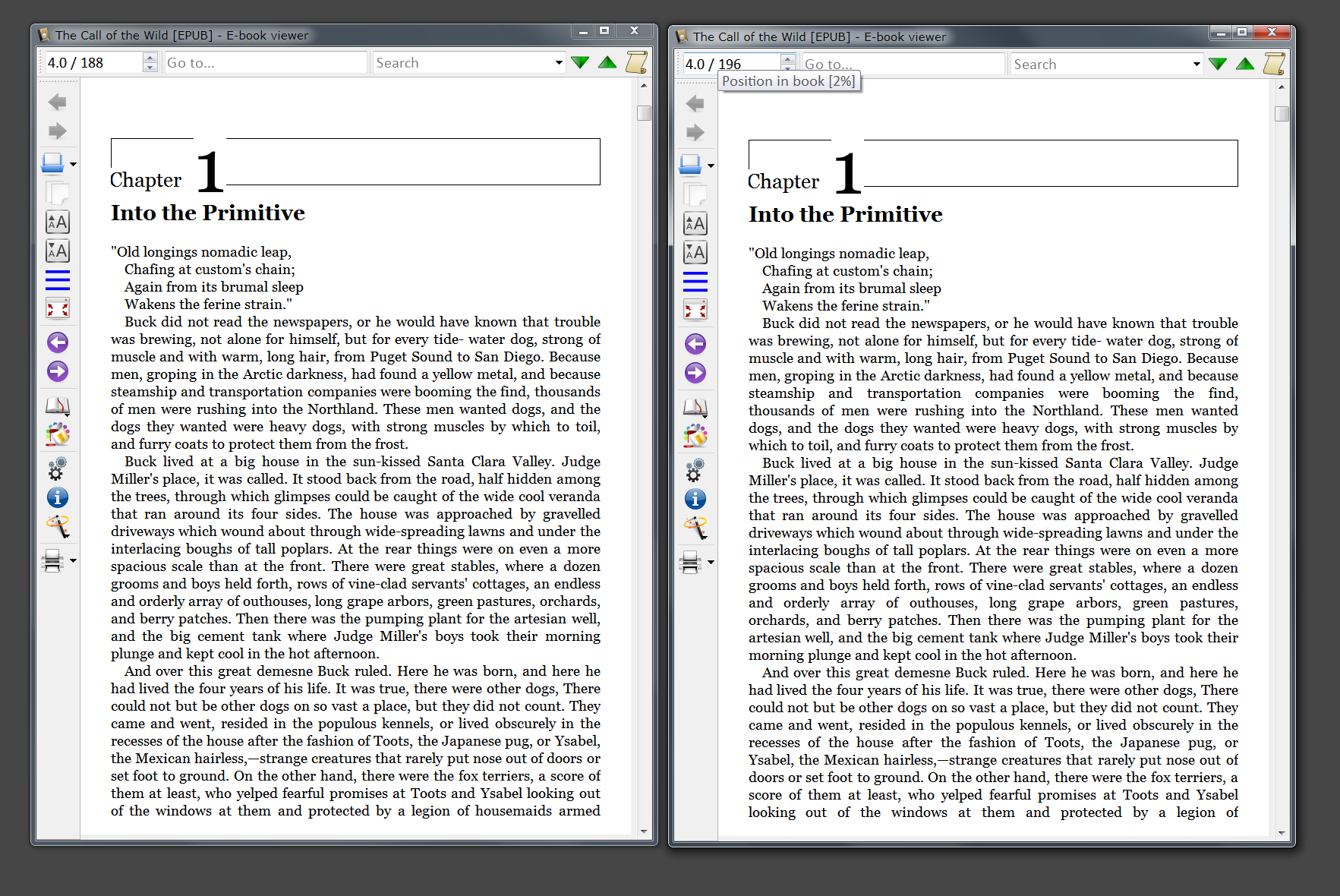

Another screenshot, of a different book (and the book itself). Left shows the book before Hyphenate This! applied, right shows it with. AFAIK, the plugin hasn't changed for ages apart from the conversion to QT5, and I have not seen anything weird after that, using Calibre 1.48.
PS: I remember that Sigil had this exact same issue, so it may have something to do with the settings or configuration of the browser component.

To be 100% sure, I have installed Calibre 1.48 Portable.
This viewer handles the hyphens as expected; in the attachment below you can see the viewer of Calibre 1.48, without hyphens left, and with hyphens right.
The book is the same as the one linked above.

Again, looks fine for me, see screenshot of hyphens_yes.epub
Try restoring the viewer preferences to defaults and see if that makes a difference.
