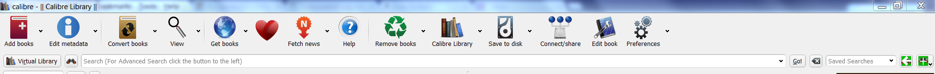

maurices5000
maurices5000 began at the beginning.
Posts: 71
Device: Kindle Voyage
Polish wont update metadata in MOBI files
But the recently added Embed Metadata tool will do it. Because it's a recent enhancement you may need to add it to one or more toolbars, or select book(s) press ctrl/E (cmd/E on OS/X) then select MOBI and press OK.
To add something to a toolbar you first need to select the relevant toolbar from the long drop down button at the top of the Preferences->Toolbars panel; then find the tool in which you're interested the left hand list, and 'move' it to the right hand list with the the right pointing (→) blue arrow. Don't forget to click 'Apply' to make the changes 'stick'
I attached what my screen look like.
1) In the first picture I select Preferences.
2) I select Toolbars under Interfaces
3) I get a drop down list not two listboxes with arrows.
Thanks! Can you provide screenshot or something for me to better see waht you mean!
I greatly appreciate it.

Old 08-21-2014, 01:11 PM   #13
Posts: 31,206
Karma: 60406678
That is because you have not chosen WHICH toolbar yet.
Old 08-21-2014, 03:45 PM   #14
maurices5000
Posts: 71
Thanks Ducks! I see my error. Ok that part if fixed.
I still don't get anything when I select the MOBI ebook and press the Embed metadata button.
I also tried doing the following
select MOBI book press ctrl + E then select MOBI and press OK.
On the main screen where I see my list of books, I don't see a pop up or a MOBI button to select, when i select the book I want to edit. There is no OK button either.
Ok, well if i don't select a book before clicking the Embed Metadata button, I get an error message. But I only get a pop up or dialog box (with MOBI in it) when i select the second option shown in the picture.
It doesn't give me the option to edit anything.
