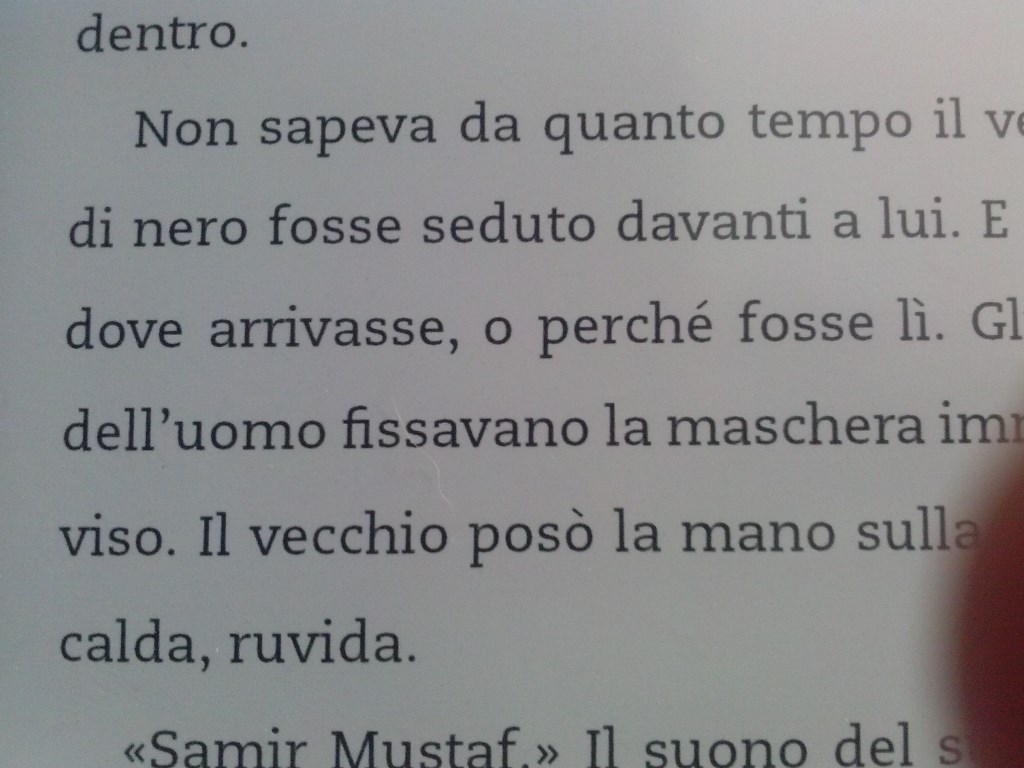

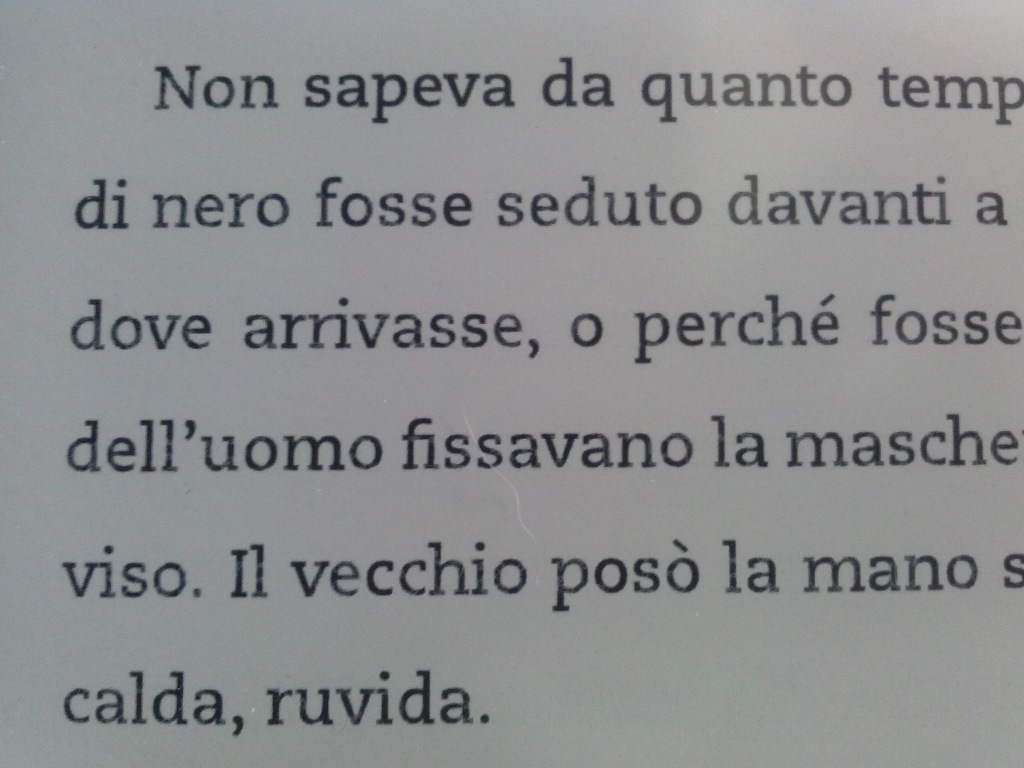

Hi,
I'm sorry if the topic has already been brought up but I tried to search for a thread with a similar problem on the forum but I couldn't find it.
Anyway, something very upsetting happens to my aura hd.
If i set the refresh to 6 (pages) the difference between the first one after the refresh and the last one (just before the refresh) shows something from high resolution to low resolution, where characters seem to lack ink and definition.
This happens with firmware 3.3.0 and 3.5.0. reading epub
I don't know if it's my kobo or anything else.
Any suggestion?
Attached a couple of pics to show what I mean.
Thanks

That's consistent with mine. I set the refresh to 3 pages but you can experiment to meet your own preference.

Agree with Barcey. That is consistent with my Aura HD too, mine is kept to refresh at every page turn.

I find the every-page-turn refresh less distracting, I presume because my brain is expecting it. Nicer text is a pleasant side effect!

I've never actually seen one of the every-50-99-pages people post high-quality close-ups, though. I've just assumed that it's largely differing tolerances, eyeballs, and brains. I'm sure there are plenty of people who simply wouldn't see the ghosting artifacts that bother you and me. And more power to them!

It's the nature of e-ink. Ghosting is less bad than with older screens, but it's not non-existent. Just refresh more often. I do recommend trying every page, for a couple of hours, if ghosting bothers you; it's likely you'll simply stop noticing the refresh.

It's simply the limit of e-ink technology, and all e-ink based e-readers exhibit this behavior. Just be thankful that Kobo allows you to customize the frequency of page refreshes, since not all e-readers give you this option.

The Aura (NOT the Aura HD) has the software means to behave slightly better in that regard (like the Kindle PW2). It's been a while since I've seen one in person, so I can't vouch for how well it's implemented and/or works on a Pearl screen vs the Carta of the PW2 (where it works pretty damn well).
That said, the font & rendering settings can have a rather large impact on how badly the partial refresh 'eat' at the sharpness of the font. I tend to prefer well hinted fonts (usually CFF ones) for that reason: you usually end up with very sharp fonts, without a lot of fuzz around the edges to begin with.

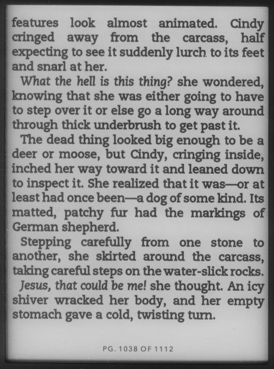

I don't notice that happening at all on my Kobo Glo. Thinking it's something I just don't notice, I scanned a page at 200% to see if I was missing it. These are the 2 scans, one on the page freshly refreshed, and one after 40 page turns. I resized them back down to normal so they wouldn't be huge images. If I didn't know which was which, I wouldn't be able to tell which was the refreshed page and which was after 40 page turns.

I stick to firmware 2.4.0 for several reasons, and the font is Caecilia which is one of the stock Glo fonts.

Note that @Ripplinger is using (pardon my French) big-ass bold fonts, which certainly plays a part in the difference in behavior .

I find the ghosting is much more noticable if the lines of text don't fall in exactly the same position on every page, such as when there is a space between paragraphs that is not the same height as a line of text. (This occurs with books published by Baen for example, where there is often a 2 pixel space between paragraphs).
I think temperature also has a big effect: in cool conditions ghosting on my Glo is much less severe than in hot conditions. On a cold winter's day like today 40 pages between refreshes is fine. But on a hot summer's day I wouldn't want to go more than about 10.
